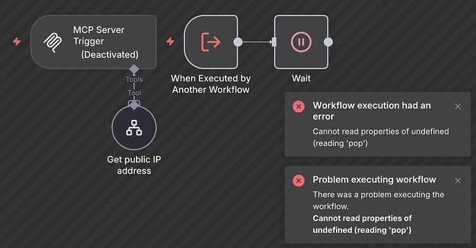

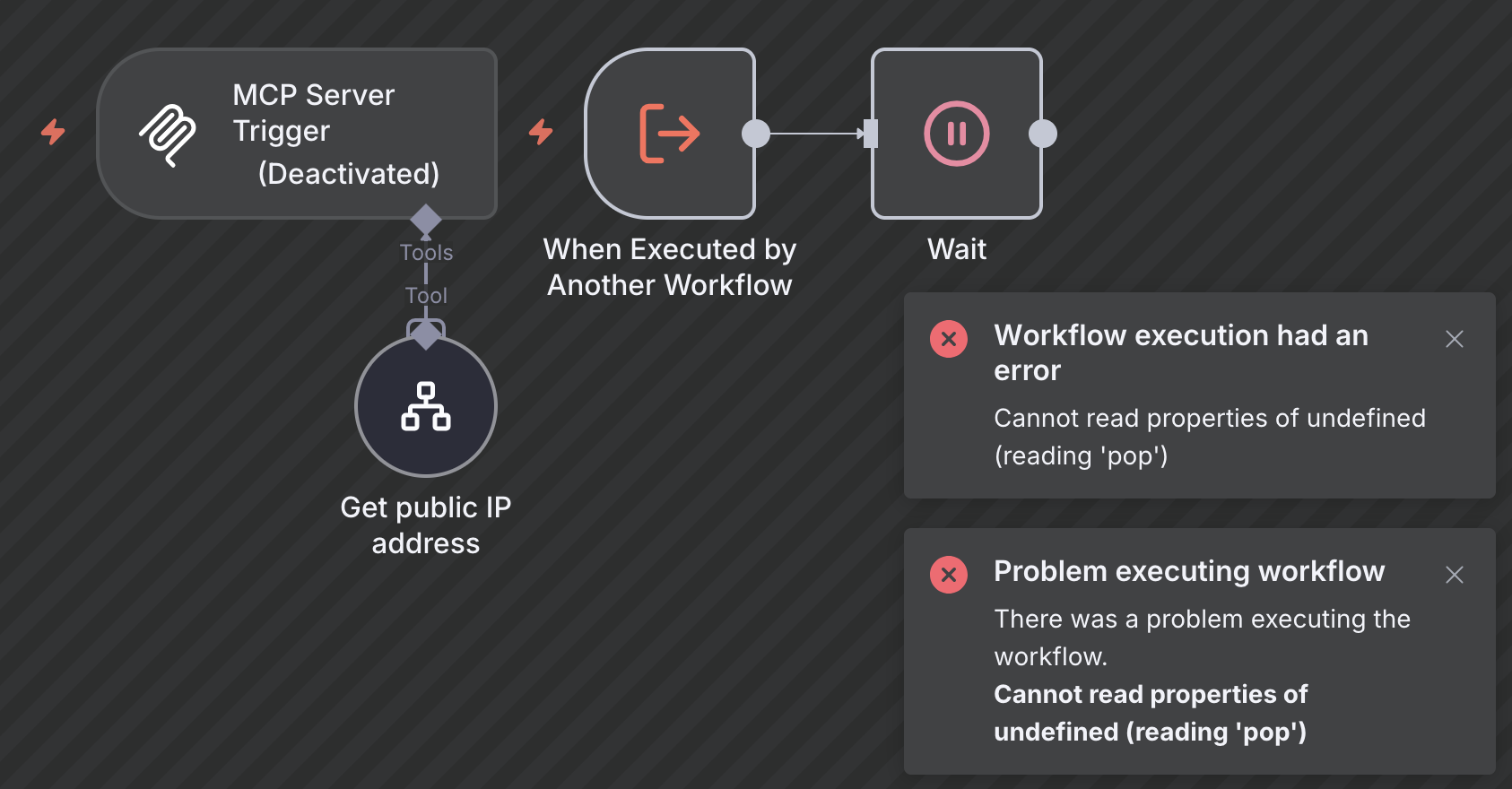

I’m facing the same issue. Exactly the same situation and message.
However, I can give some more insight and minimum workflow to re-create the issue.
Basically, what I’m attempting to do is: in the context of an AI agent development external to n8n, when a MCP tools runs into a timeout, the agent crashes. I want to use n8n to create a long-running MCP process asset, enough to crash the AI agent, so I can get the logs.
I created a MCP server that calls a workflow, which features a _wait_ node. Interestingly, it works when you define a wait time of about 1 minute, anything above 64 seconds will fail the execution.
An alternative solution for me: instead of using a workflow call tool in the MCP server I used a HTTP tool, from which I called an internal HTTP endpoint with the wait node. A bit of a workaround, but still fulfilled the task.
