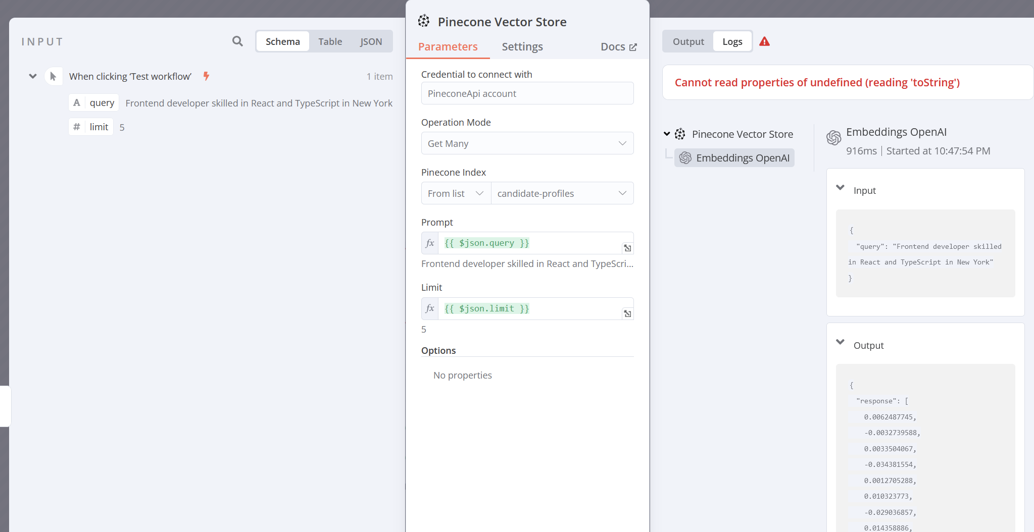

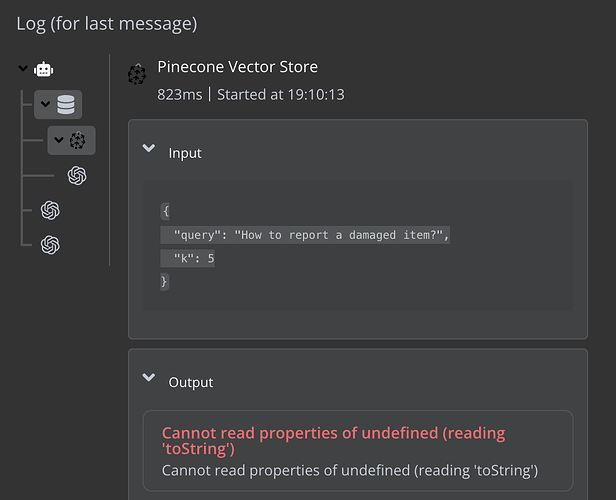

I’m currently getting “Cannot read properties of undefined (reading ‘toString’)” error from Pinecone. What’s wrong?

I insert the documents into Pinecone not via native node, but HTTP, as this allows me to set custom ID used then for upserting. I was passing metadata for vectors like title and body (for each help center article) and the error was there.
I uploaded the vectors via native node and in Pinecone I could see the metadata being text (and a few others). Then my AI Agent node worked fine, and retrieved text as pageContent.
I attempted to use my custom workflow and insert documents via HTTP node once again, this time by setting the key to text and it worked fine.
Could someone confirm the AI Agent node expects key named text, and therefore when inserting documents via HTTP the metadata key name has to remain text as well?

Hey @aya,
Looks like someone ran into the same issue and figured it out:
Content apparently needs to be passed as text and the different key name will cause this to fail.
