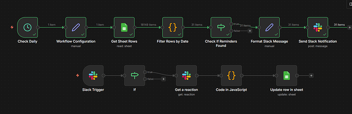

Process looks like this
  1. data in google sheet with a follow up date
  2. when follow up date is reached, slack will send message (this part I completed no problem on n8n)
  3. react to the message with a checkmark and n8n will see this reaction and update google sheet cell by 30 days for next follow up
I’m stuck on step 3
When I react to the message, the slack workflow doesn’t react, I tried in test and live mode
I’m running slack on self hosted vps. n8n 2.1.0
I gave it the necessary permission in slack API website.
The AI bot is already in the Slack channel because it is already sending me reminders.
It just cannot seem to detect reactions that I have given messages.
**I WONDER IF I CAN KEEP BOTH WORKFLOWS IN THE SAME CANVAS OR NEED A SECOND WORKFLOW, I TRIED TO COPY AND PASTE THE BOTTOM FLOW INTO ANOTHER CANVAS
AND
TRIED TO PUBLISH IT SAID I HAD THE SAME URL WHICH MAKES ME THINK I HAVE TO GENERATE A SECOND URL FOR THE TRIGGER WORKFLOW IN A SEPARATE CANVAS BUT I’M NOT SURE HOW.**

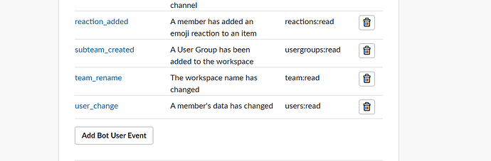

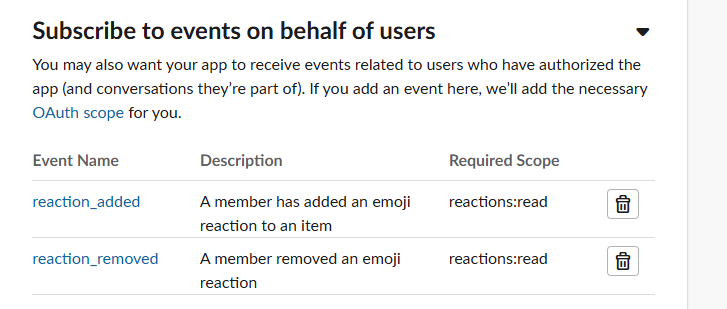

The permission I have given for subscribe to bot events is
reaction_added A member has added an emoji reaction to an item reactions:read

And yea, is better to keep in another workflow the Trigger(from my view point).
Cheers!
I figured it out it was a pain in the ass.
Had to separate 2 workflows.
