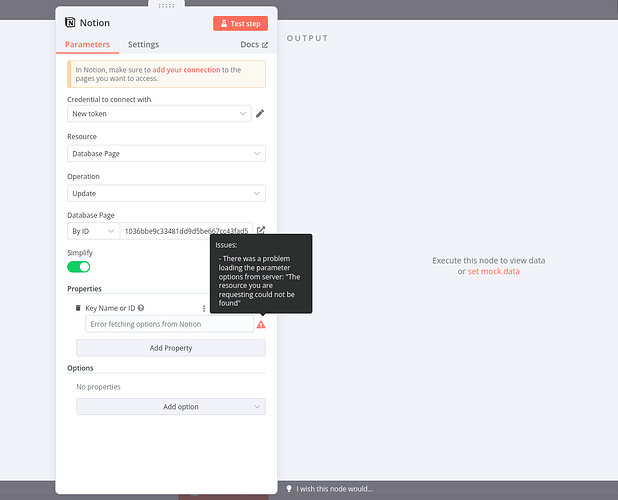

Cannot update a database item on Notion since 11/09
Using n8n cloud : I’m trying to update a database page.
If I try to update a page created before 11/09/2024, then I’m able to select a field to update (and to update the field).
If I try to update a page created after 11/09/2024, then I’m unable to select a field to update.
I tried to use page ID or URL and nothing works.
When I try to select a property, to update a page created after 11/09 then
I’ve got the error "There was a problem loading the parameter options from server: “The resource you are requesting could not be found”.

Screenshot of the error :
Hi @wawax,
It looks like you’re using v1.58.2 of n8n and this issue might be related to this one here: Valid Notion page IDs are rejected · Issue #10831 · n8n-io/n8n · GitHub. Could you try upgrading to the latest to see if that fixes this issue?
HI Aya,
I’ve just setup an n8n 1.59.4 instance on my computer.
it’s working with this new version.
thank you ! :smiley:
Same here with version 1.66.0
Not able to retrieve properties from a database in update notion database block
