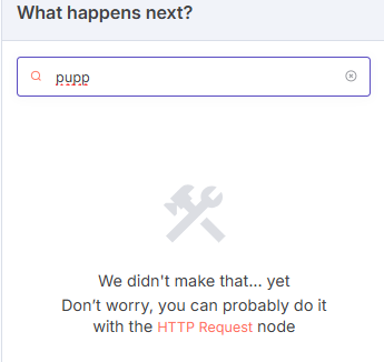

Can't find Puppeteer
How do I install n8n-nodes-puppeteer?

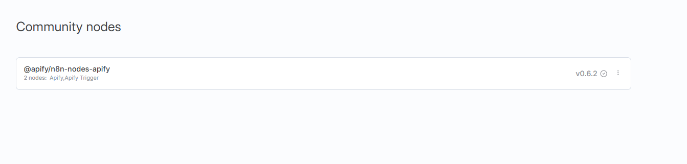

Under Settings>Community Nodes there is no Install button.
If I type Puppeteer into the Nodes panel it can’t find it?
But is does exist…GitHub - drudge/n8n-nodes-puppeteer: n8n node for browser automation using Puppeteer
Is this only for local installs though, can I do it on n8n cloud?

Thanks Naufal, I’m not running this locally but from the browser/cloud and I’m running instance 1.110.1 – so I’m not sure I can do this?

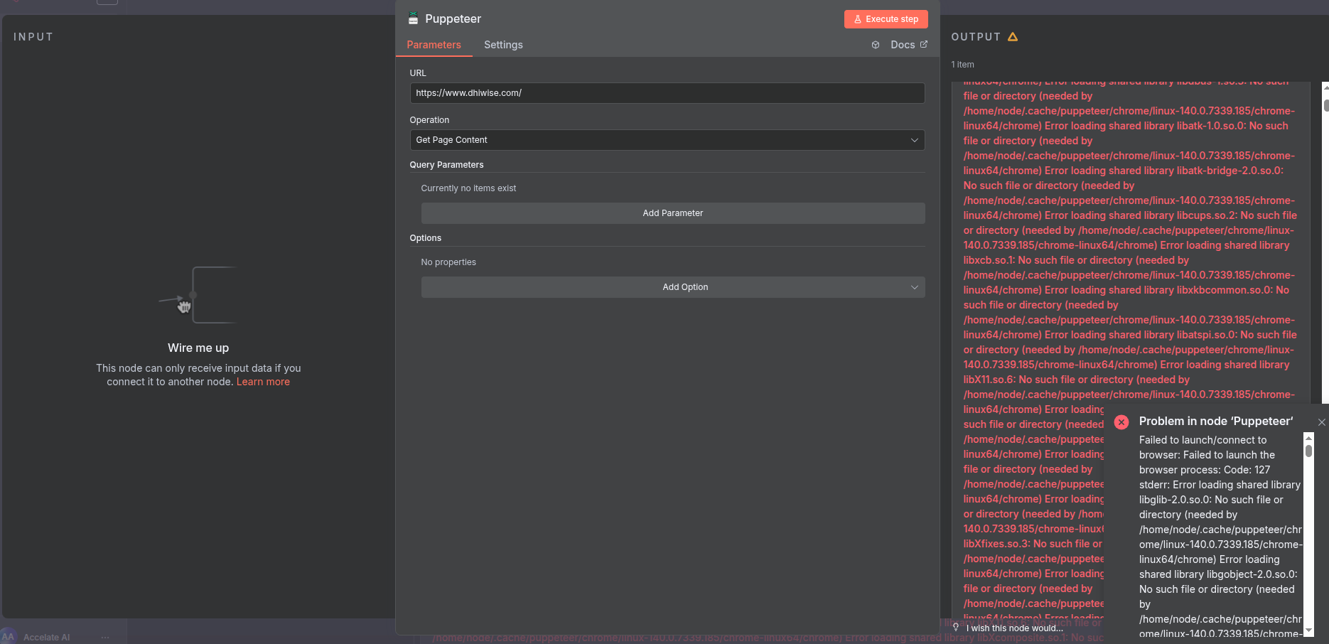

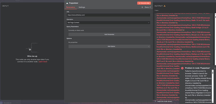

But that gives an error for the Chromium browser,
I think that was not installed, so what is the solution?
