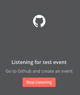

It actually doesn’t visibly fail and it doesn’t show any error messages :
it just hangs in “waiting for trigger” like this :
i am testing it in the trigger configuration screen where you have the “test step” button, i just click on it and go to the repository and start and unstar the repo to see if it gets triggered ( i do set the trigger event to the wildcard ).
