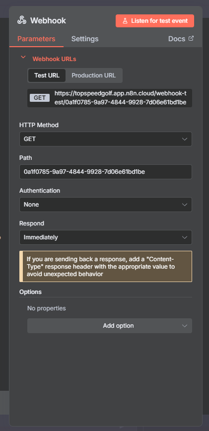

You should use a webhook to receive the requests in your n8n instance.
Activate your workflow and use the Webhook Production URL:
Thanks for the quick reply!
Would I need to adjust any other settings in this webhook node?
Also, how do I test this out and see if it’s working? Can you write me a quick Windows PowerShell command to run to test it?
If you use the GET method, you can open the URL in your browser and you’ll see the execution happening in n8n.
Browsers make GET requests to webpages you access.
You can either use the test URL while listening for a test request, or activate your workflow and use the production URL. If you use the production URL, the execution will only show up in the execution tab.
To choose the right settings for the webhook node, you should refer to the documentation of the service you’re using the make the request.
But n8n’s official webhook docs might also help.
