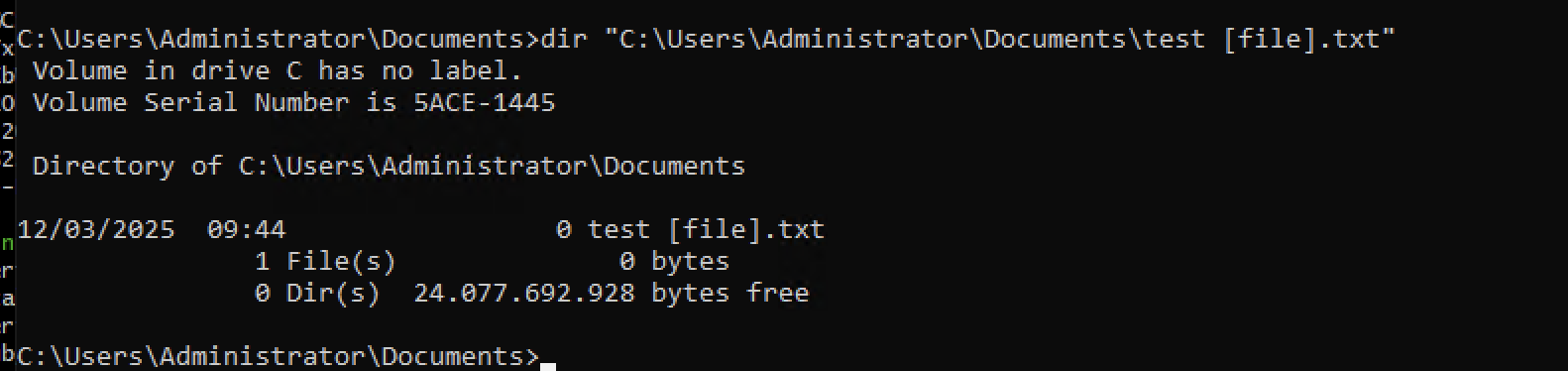

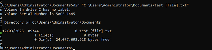

Ok I have some windows I could spin up for testing … yes this seems to work.
so try this …
