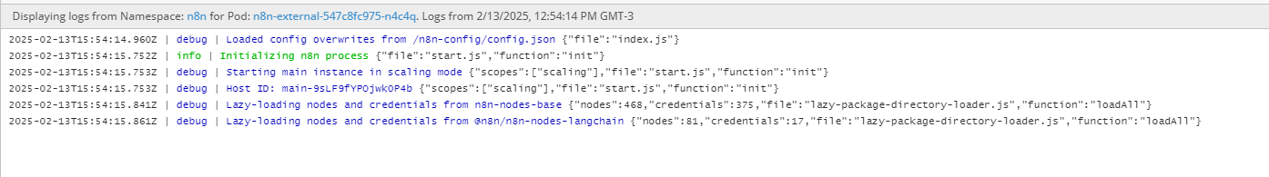

Hi, i deployed a n8n in k8s using the helm repo without any problems. but when i change in the configuration the port (via N8N_PORT or config.port) to 80 it doesnt init the n8n, even trying from the container port can’t run the n8n.
in the logs hangs here
Doesn’t throw error

hello @cocuba
Probably the issue is that you are starting the n8n without the root/sudo privileges. Ports under 1024 are privileged. Or the port is already taken by another service
