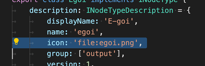

are you referencing the icon in the description.icon? Also where are you running the build command you have to be in the root folder.

So if you run npm run build it does run that and so also copies the icon. Is the icon really in the same folder as the node and did you reference it correctly like in the above example from ricardo? And did you also restart the n8n main process and refresh the browser?

npm run build copies the PNG/SVG icon at packages/nodes-base/nodes/[nodeDir] and places it in packages/nodes-base/dist/nodes/[nodeDir].
If you have added the node in package.json, referenced the icon inside the node, and built so that the icon is in the dist dir, restarting and refreshing should work.
