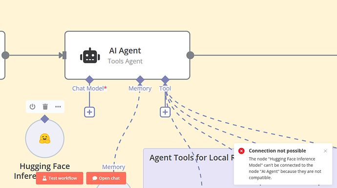

Cant use ai agent with Hugging Face Inference Model
Connection not possible
The node “Hugging Face Inference Model” can’t be connected to the node “AI Agent” because they are not compatible.
  • n8n version: 1.81.0
  • Operating system: Linux
Hey, try connecting the Hugging Face Inference Model node to the Basic LLM Chain node instead. Here’s a template example: Use an open-source LLM (via HuggingFace) | n8n workflow template
And here is a list of models that you can connect to the Tool Agent node. The Hugging Face Inference Model node is not listed here: Tools AI Agent node documentation | n8n Docs
