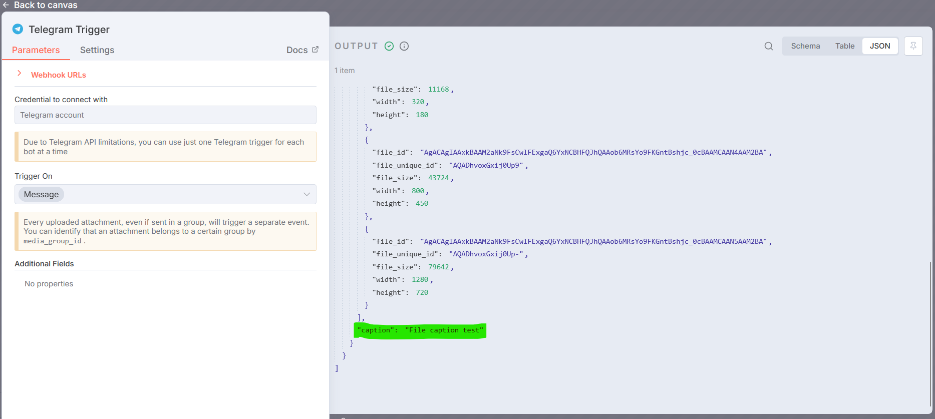

Hi @nic11371 ,
which n8 version do you use?
I just tested it with n8n version 1.112.5 and it works fine!

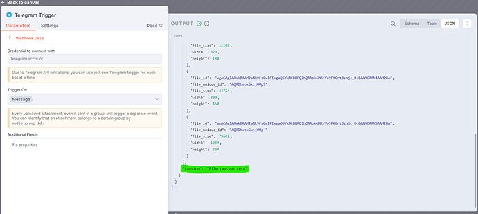

Caption is only shown for the last file.

“caption”: “File caption test”
Yes, I’ve actually faced this issue before and I think I know the reason behind it.
The problem occurs when you upload multiple images along with a caption, Telegram assigns the caption to only one of the images, while the rest remain without a caption. That’s why in n8n you “sometimes” get a caption and “sometimes” you don’t, it’s random at this point!
I’m not sure if this is something that can be fixed on the n8n side, or if it’s a limitation from Telegram itself.

Ah, I allways tried with one image!
Now I tested with 2 images an can confirm this issue!
No caption is received…
