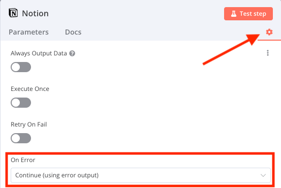

You can define a second output of a node which you can use to handle the error.
Screenshot 2024-06-03 at 5.08.06 PM
