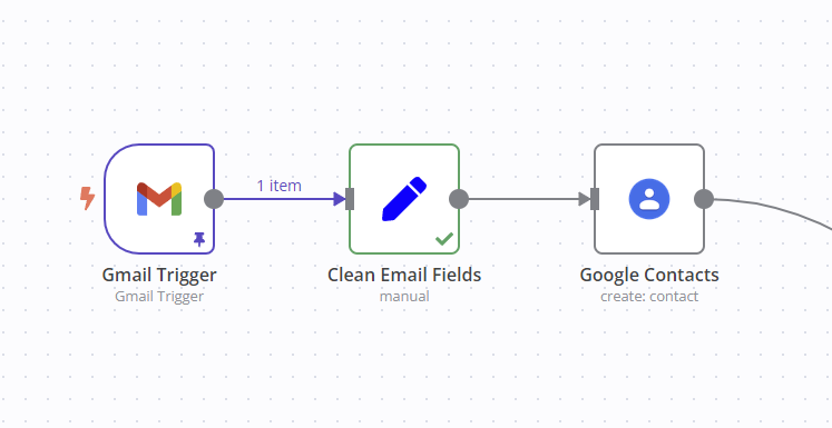

I’m trying to workout the cleanest way to do this. I have an input which is at Gmail trigger. From this node I can get information which I will use to create a Google contact.
There’s just one part that is different. Emails will come from different web forms and they will be structured in a similar way. I want to set the Google contact note field with some information about which form came from.
I have something like this so far but I need some way of setting
Google contact note = X
and then I have a sort of mapping between say the email subject and a word.
What’s the easiest way of doing this without duplicating these three nodes once for each mapping/?

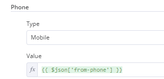

Also another issue is I want to be able to set the phone number. I want to do a very simple processing basically if the phone number starts with ‘04’ then set the type to mobile otherwise set it to work.
hello @bally
You can set for each form trigger to execute a sub workflow. And in the sub workflow you can define all the logic, so it would be like that:
N flows with triggers
and a sub workflow with the logic
