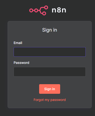

I did that and restarted, and black screen stating “bad gateway” shows up.
Actually it’s working
n8n.srv968941.hstgr.cloud
please try refresh again!
omg, thank you so much! it worked!
