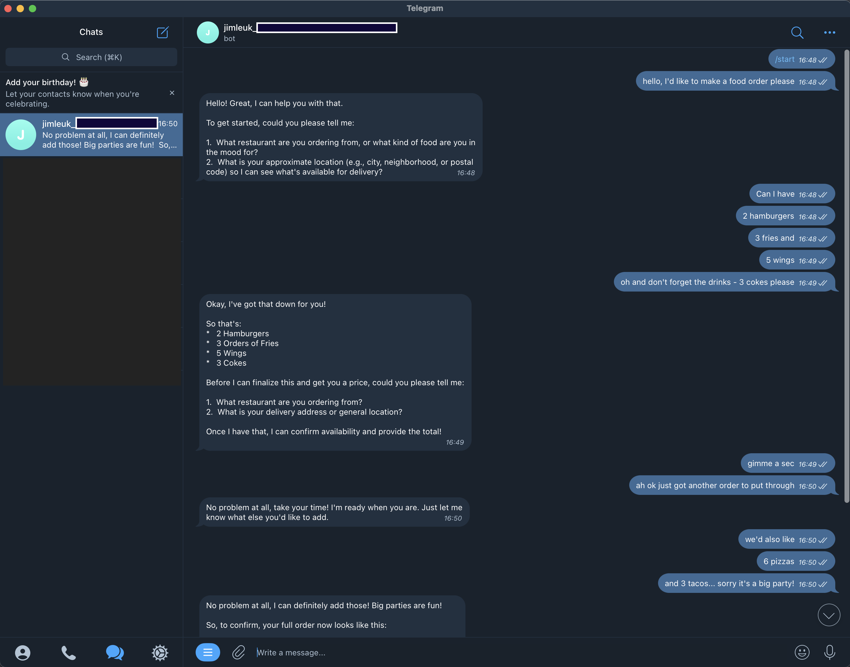

The “prediction” step is where I use an LLM to analyse buffered user messages to determine if the agent should send a reply. The analysis uses a text classifier with 2 outputs - true if end of turn is detected or false if there’s likely more to follow.
The challenge with this kind of workflow is that you don’t necessarily want to run inference on every execution. The risk being that with parallel running predictions, you could get duplicate replies sent and turns state going out of sync.
My solution to this problem was to implement a single loop which only starts running when a new start of user message is received and when the prediction is false, waits for more buffered messages before looping back around and trying the prediction again. To implement the “waiting” for new messages, I used n8n’s wait node.
The trick is very much in the “waiting”. Rather than being time-based, the wait node is set to be resumed by webhook whereby a HTTP request must be made to the execution’s resumeURL to continue. When we receive new messages and we detect a prediction loop is already active, instead of starting a new prediction, the message is buffered and triggers the resumeURL. This triggers the “waiting” execution to continue which resumes the prediction.

- Turn detection definitely feels more sophisticated as a solution. It’s definitely noticeably less interruptions and as a user, I also don’t feel the rush to reply and when I’m finished, the agent replies with little delay which feels like a more “natural” and “realtime” conversation.
- Using LLMs for turn detection can actually work! I don’t think I’ve used the most optimal prompt or the fastest model to do the prediction task so there’s plenty of room for improvement.
