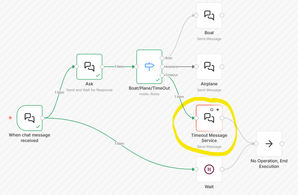

I also tried to do a “watchdog with a Wait”, but Timeout message node gets there stuck and the wait node never executes.
I want the timeout message because I need to end the execution and inform the user that the session has expired and that they need to open it again or refresh the page (F5). This only makes sense if the user is still there. But of course, if the user closes the window, there’s no point in sending a message — and there’s no way for me to know that.

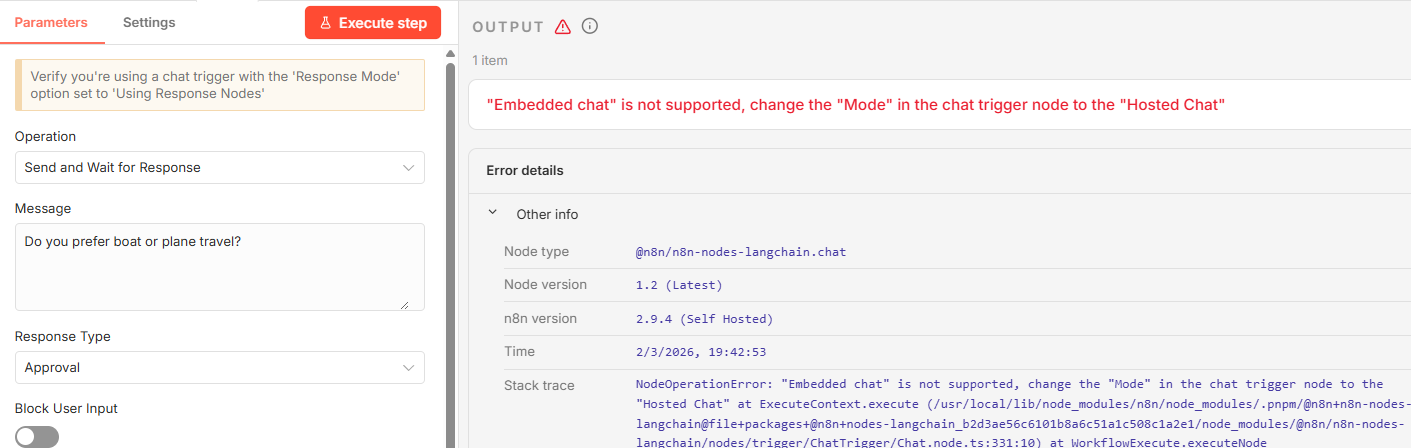

I have also noticed that this cannot be used with “Embedded Chat” in the Chat Trigger node. I hope this gets fixed in upcoming updates

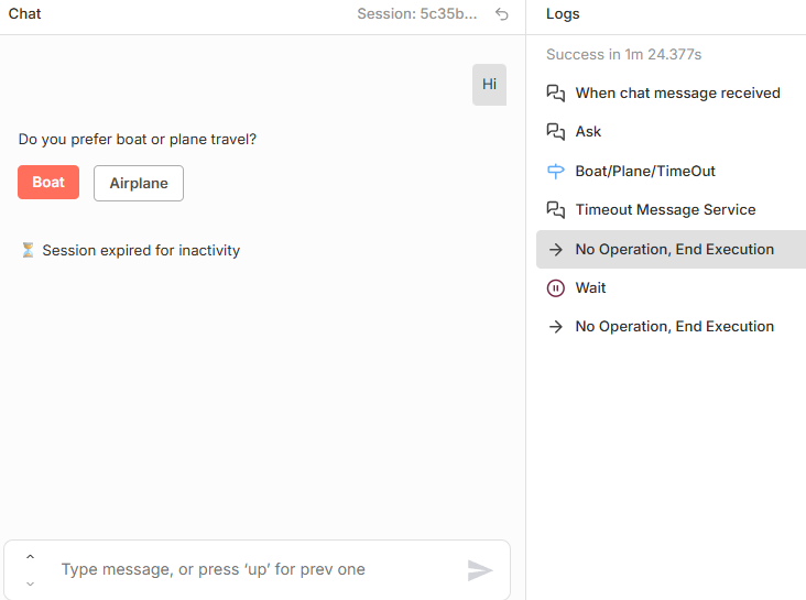

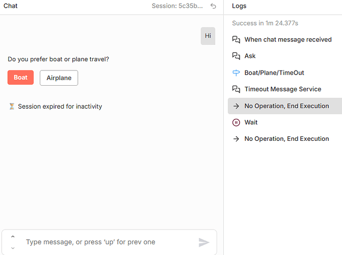

I found a very simple solution: use the “Send and wait for response” option in the Timeout Chat Node as well (the one that displays “Session expired for inactivity”).
This way, if the user closes the window before replying to the previous Send and wait for response node, the Timeout node will be triggered. And since that Timeout node also won’t receive a response, the flow will end after this final timeout.
