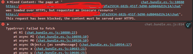

Actually, Sending a message is not triggering the Workflow at all. But in the console, im Getting this error
