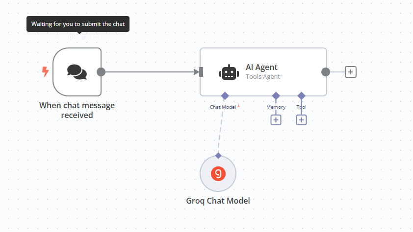

When I try to submit a message, I just get the typing gif forever and when I click the “Stop listening” button, nothing happens. I have to refresh the page to get it to stop.
This is my chatbot setup:
I have double checked my credentials for Groq
Any help would be much appreciated.

This information is included in the original post.
Some additional information is that we running this service behind Nginx
I determined that Nginx was blocking the SSE. This is resolved now
