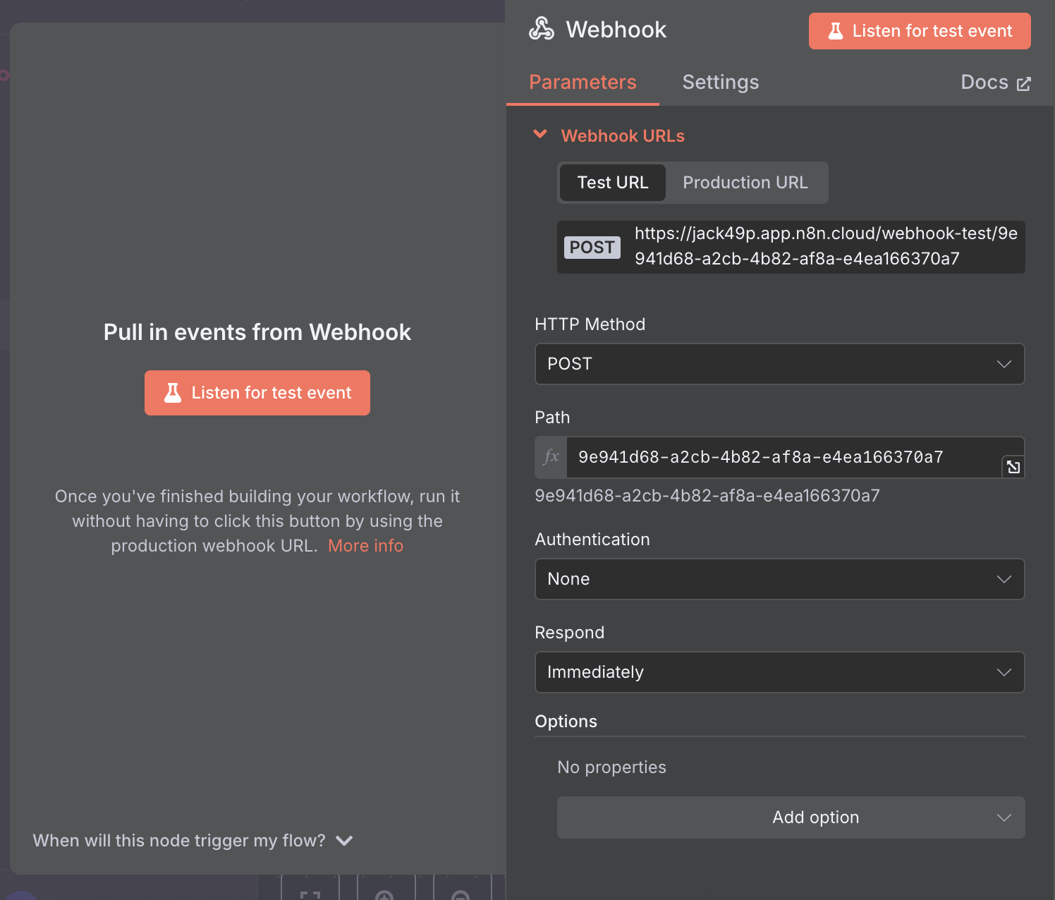

on the chatgpt side it it says that the POST isn’t active on the n8n side (which its), I have the correct URL implemented in both chatgpt and n8n, anyone have other ideas ?
error POST
error POST

I create an action to connect GPTs with a webhook in N8N installed in hostinger but it say "not able to reach webhook)
If I try curl command it suxceed,
If I try to connect N8N on Cloud it suxceed.
hostinger not.
I have the exact same issue. I have a self-hosted n8n server with Hostinger and created multiple actions in a custom GPT that should kick-off a flow in n8n through a webhook. They always work when triggered through a curl command. They only work randomly when triggered through the GPT.
When using a VPN connection to mimic requests coming from various locations, I also have issue connecting to my n8n VPS. So, I am thinking there is something wrong with the DNS resolver. Anybody experience with this?
