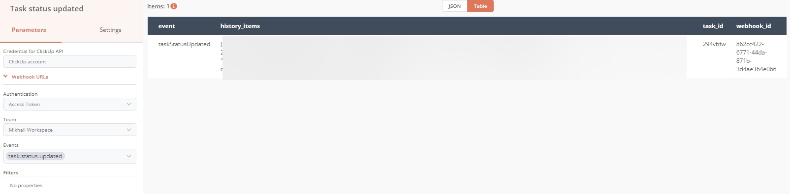

Why does the “ClickUp Trigger” with Events = task.status.updated trigger on task creation ( Events = task.created ) ?
When I create 1 task in ClickUP, two events happen one after the other (at once):
There was no task before and the status of this task did not exist, why does the ClickUP trigger for changing the status triggered?
Thank you!

Just to follow up from what @MutedJam mentioned I have just taken a look at ClickUps API docs for webhooks and it looks like they send a created and updated webhook on creation of a new item.
taskCreated payload
This webhook is triggered when a new task is created. We also send the taskStatusUpdated payload when a new task is created.
webhook_id
a78634b5-341c-4db5-8b7c-98655878b7b9
862cc422-6771-44da-871b-3d4ae364e066
task_id
294vbfw
294vbfw
