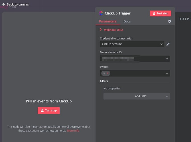

Can you share how you have the trigger node configured?
Doesn’t get much easier than that :thinking:
