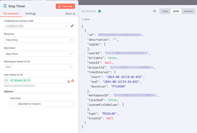

I’ve opened a PR that should tackle some of what you’re trying to do.
BTW I like the Aqara cube trigger to stop the timer :ok_hand:
It has an optional end time which defaults to now()
