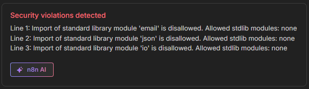

The Python (Native) node ion n8n cloud version 2.3.6 can’t import Python standard libraries like these ones:
import email
import json
from io import BytesIO
Line 1: Import of standard library module 'email' is disallowed. Allowed stdlib modules: none
Line 2: Import of standard library module 'json' is disallowed. Allowed stdlib modules: none
Line 3: Import of standard library module 'io' is disallowed. Allowed stdlib modules: none
“errorMessage”: “Security violations detected”,
“errorDescription”: “Line 1: Import of standard library module ‘email’ is disallowed. Allowed stdlib modules: none\nLine 2: Import of standard library module ‘json’ is disallowed. Allowed stdlib modules: none\nLine 3: Import of standard library module ‘io’ is disallowed. Allowed stdlib modules: none”,
“errorDetails”: {},

The issue is the Python (Native) node in n8n Cloud version 2.3.6 disallows importing standard library modules like `email`, `json`, and `io`. This is likely due to security restrictions within the cloud environment.

Hi @TheRealBecks, welcome!
as you already saw:
so, It’s not possible in n8n cloud atm,
You could try using something like AWS Lambda or a similar, depending on what you’re trying to achieve..
@mohamed3nan Yeah, it’s not implemented as can be seen in this new comment.
