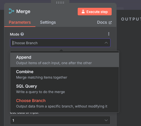

I don’t see “Pass-through” as an option for the Merge node
Appreciate the suggestions, unfortunately, neither of the solutions have worked for me.
For some reason both branches keep executing regardless of what mode I sent the Merge node to
