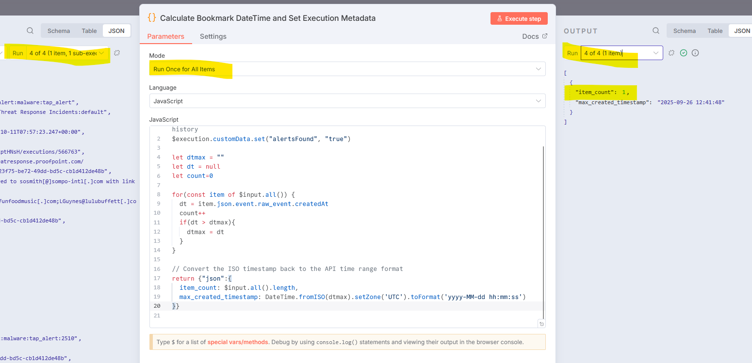

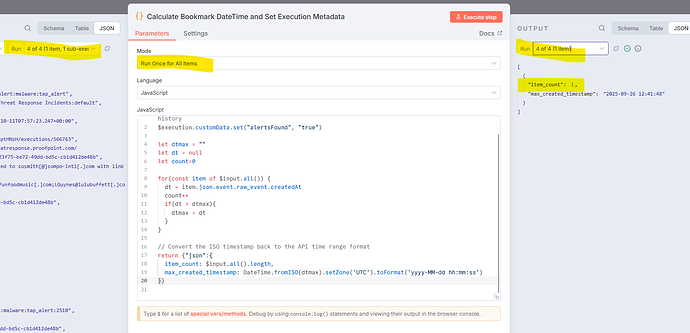

Code Node set to Run Once is running For Each
Code node (“Calculate Bookmark”) set to run once is running on each.
Expect item_count to equal the number of input objects
Debug info

Hi @hukel
It’s because of the Loop Over Items node..
You’re connecting the Calculate Bookmark DateTime and Set Execution Metadata node inside the loop path, but you probably meant to connect it to the done output of the loop node instead..
Thank you. This seems to be working.
