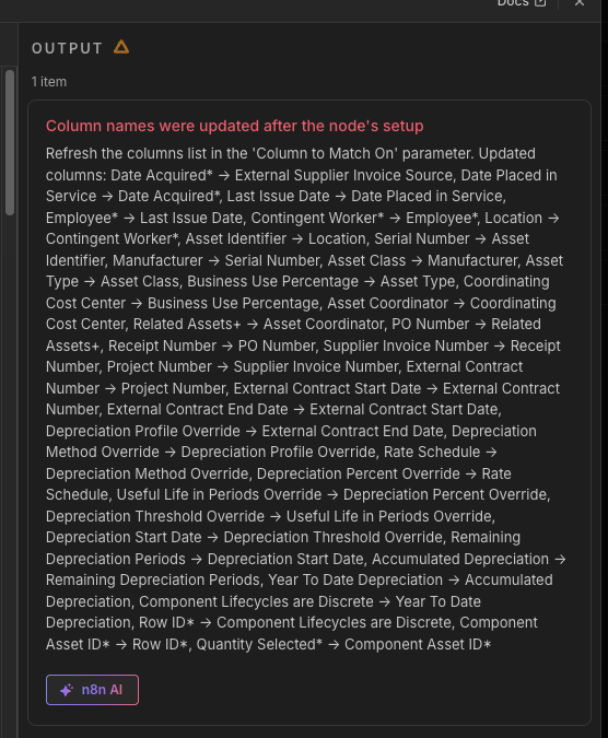

Column names were updated after the node's setup - Refresh the columns list on the 'Column to Match On' parameter
Hey is anyone getting a similar error. I have done all of the n8n AI suggested fixes (refreshing column lists, etc.) and have checked the columns and I cannot see why the mapping in the error is incorrect, vs what it is on the column mapping. Genuinely no idea how to solve this.

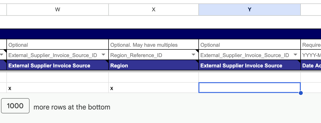

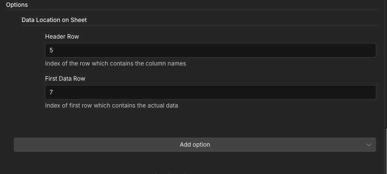

The tab in the sheet i am appending to has 5 header rows and has certain column header names duplicated , depending on the sub-section it sits under (ERP template’s standard format) and I wonder is this causing issues?

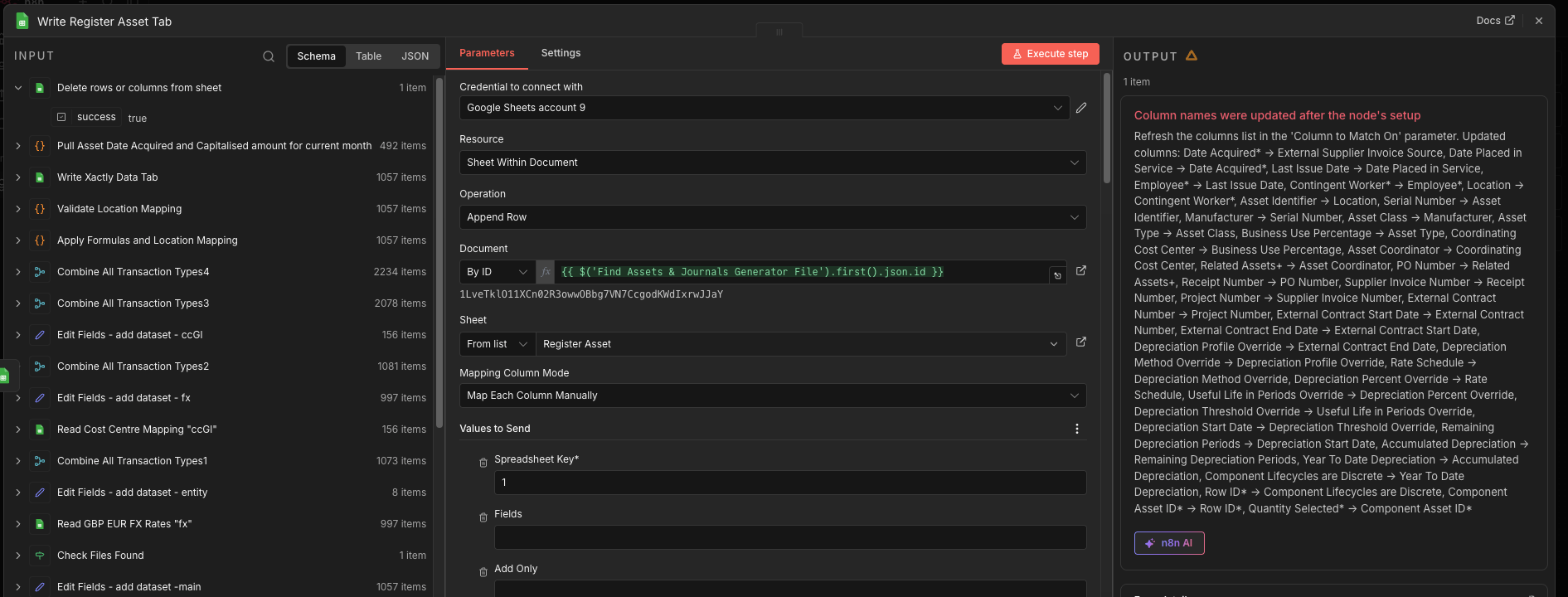

  1. The node confirg
  1. error

    I think the duplicated column name (External Supplier Invoice Source) may be causing the schema to get confused? Would this by why it is happening?

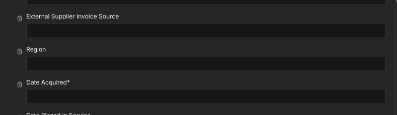

Screenshot 1 (mapping on n8n - only 1 External Supplier Invoice Source)

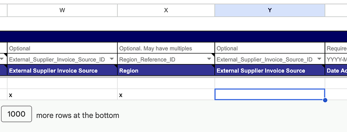

Screenshot 2 (headers on the sheet - 2 External Supplier Invoice Source columns
Yeah that’s definitely it, the duplicate column names are confusing the schema lookup. Google Sheets node can’t distinguish between two columns with the same header so it just grabs whichever one it finds first and the mapping gets scrambled. With 5 header rows and duplicates you’re kind of fighting the node’s design, it really expects one clean header row with unique names. If you can’t change the ERP template you might need to use the HTTP Request node with the Sheets API directly and handle the row/column targeting yourself.
