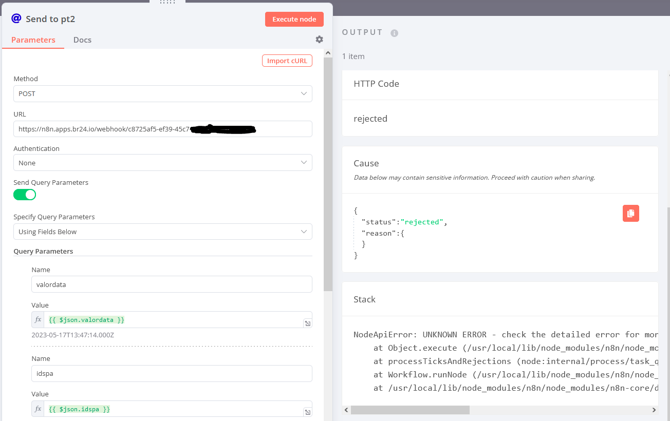

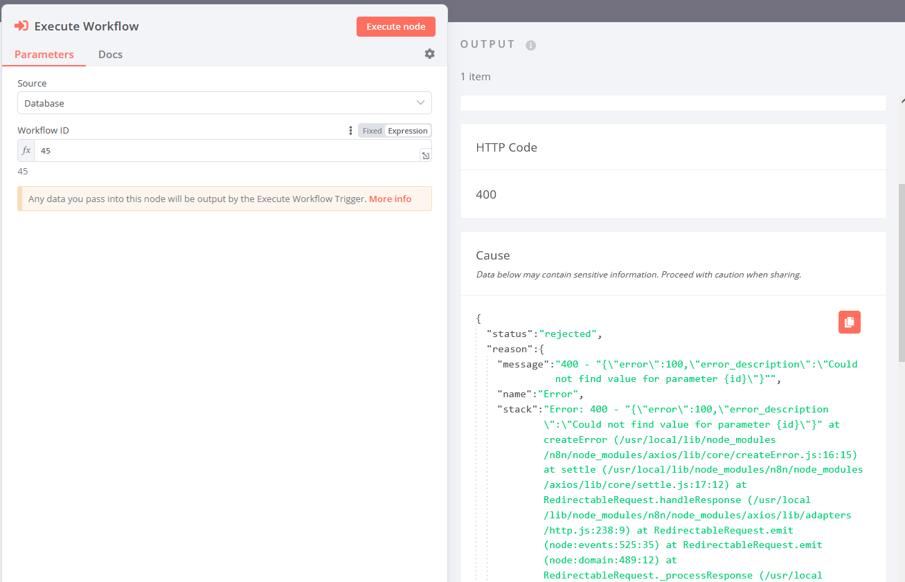

Yea, doing in the main workflow wasnt an option because there is no easy way to get the last datetime from the tasks. So I actually divided the workflow in two, the main part extracts the last datetime and then it sends to another workflow to do the if node compare. The problem that I runned into now is: for some reason the send to another workflow node isn’t working.
I tried sending it using webhook, but for some reason it only works when I click manually on execute, when I start running it i got a “rejected” message
I find something about using localhost:5678, didnt work as well. Any idea of what could be causing those errors? Thanks in advance

Looking at that first one I am not sure if it is unhappy with the 45 ID or if the workflow it is running is expecting an ID that isn’t being set :thinking: I take it the workflow you are calling does have an id of 45 and isn’t using something like a webhook trigger?
With the Webhook error rejected seems to suggest the server is refusing it, I would have expected localhost to work though assuming n8n is still using that port locally. Can you share a bit more on your n8n configuration and maybe the workflows so I can take more of a look?
