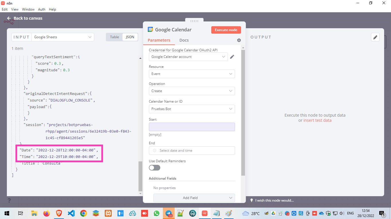

Here is the idea, I don’t know if this call tell you more.
The google sheets has Date, Time, Tittle and Description, but even if I put and Starting and Ending I will need the calculation for the calendar. That’s my problem.
Thanks @Ron_Adames!
From looking at your last screenshot it seems you’re receiving the timestamps from Google Sheets in an ISO format already:
This is good as it means we can easily parse such values and perform calculations on them. The next good news is that your Time field also includes a date portion, so we don’t need to worry about the Date field.
So with the exception of the end date we can just reference data from the Sheets node in the Google Calendar node using expressions. Here is an example workflow where I am using Luxon to read the example Time value you have provided to determine a start and end date in the Google Calendar node:
I am only using the “Summary” field of Google Calendar here (and write your Title value in it), but you can simply click the “Add Field” button to add more fields as needed.

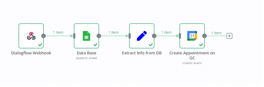

Dear @MutedJam,
Thank you so much for helping me with this. I also want to add that with these function I could solved how to make appointments using Dialogflow Chatbot and send it to Google Sheets as Data Base and Google Calendar to get the appointments. I looked for this in the community and not results till now, so I wanted to point it! The only thing I’m missing is to return the json to Dialogflow, but I will figure it out.
Thank you again and Happy Holiays!
This is the result:
Glad to hear this helped @Ron_Adames! I have not used Dialogflow, but it seems their webhooks do accept a response with a number of optional fields. So you can probably use the Respond to Webhook node for this which allows you to send a response at any point in your workflow.
Thank you @MutedJam
I solved it with some info plus this solution from @jan
I will let the workflow node for the community on here, let me know if it’s right the way I copied.
I’d like it to look like with graphic way and move it to Tips and Tricks.
Dialogflow and Google Calendar with Webhook Response
