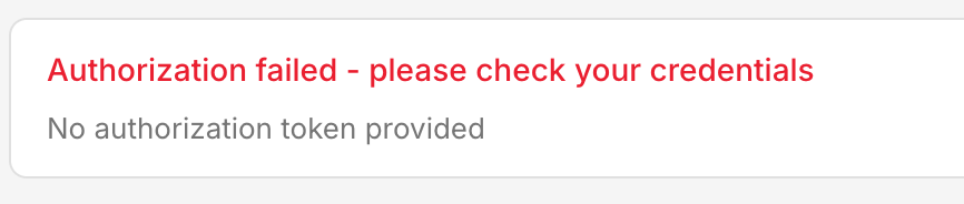

When I try to run the node, I get this error:
I’ve checked the API key and It’s correct.

Hi @Ricki_Barnahor,
According to the documentation for ideogram, you need to use the Api-Key header name and NOT Authorization.
So simply renaming your Header Auth Name should fix the problem

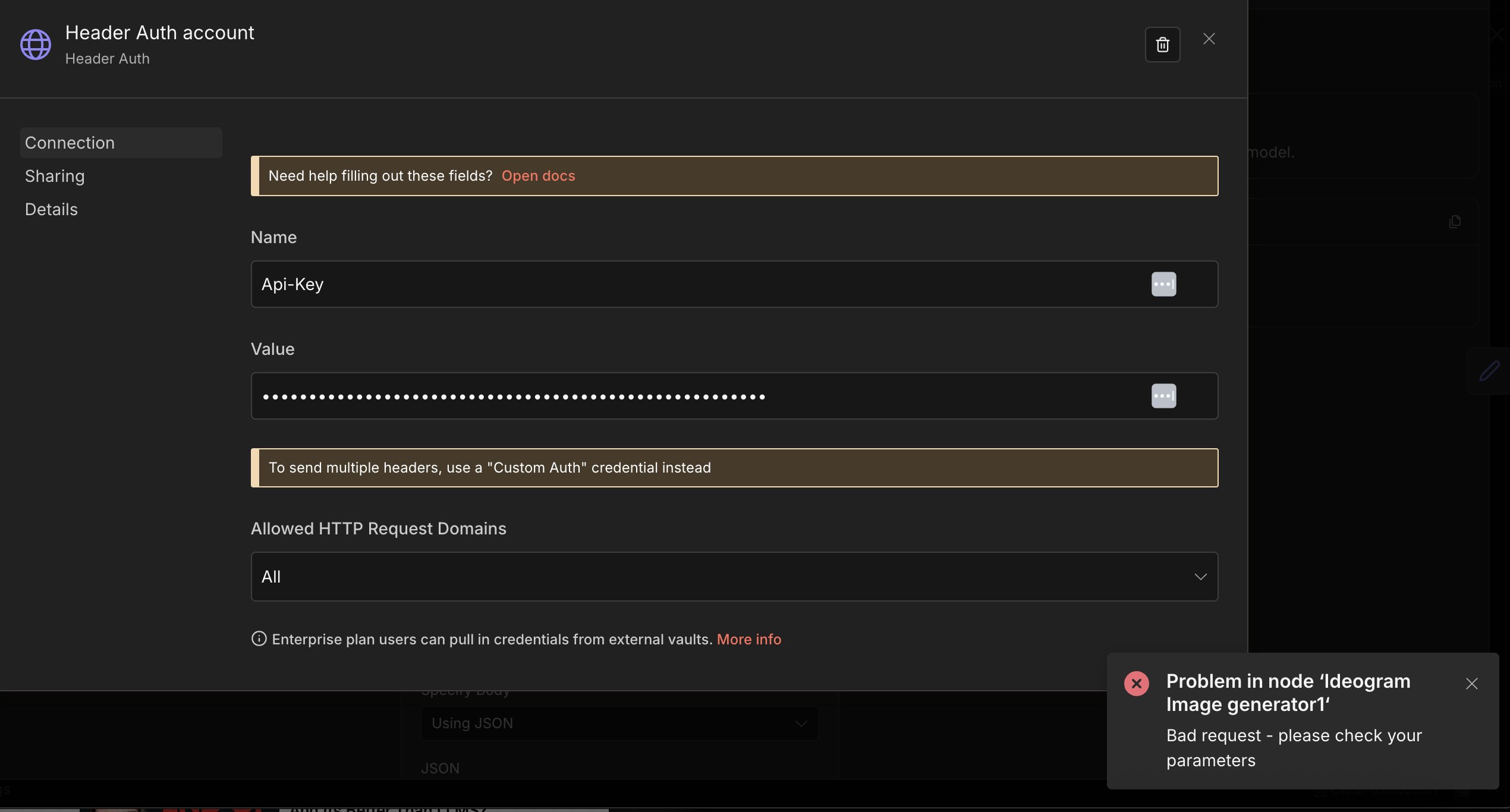

Hey @Wouter_Nigrini ,
Thanks!
I tried that, now I have new error:
What am I doing wrong?

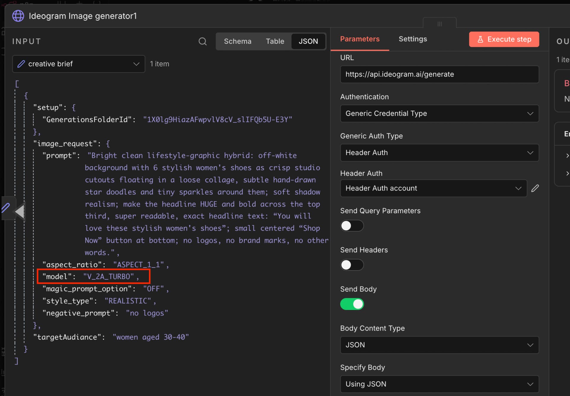

Can you share the body of the http node. Even better if you can share the workflow in a code block. Bad request usually means the data you sent to the rest api is faulty.

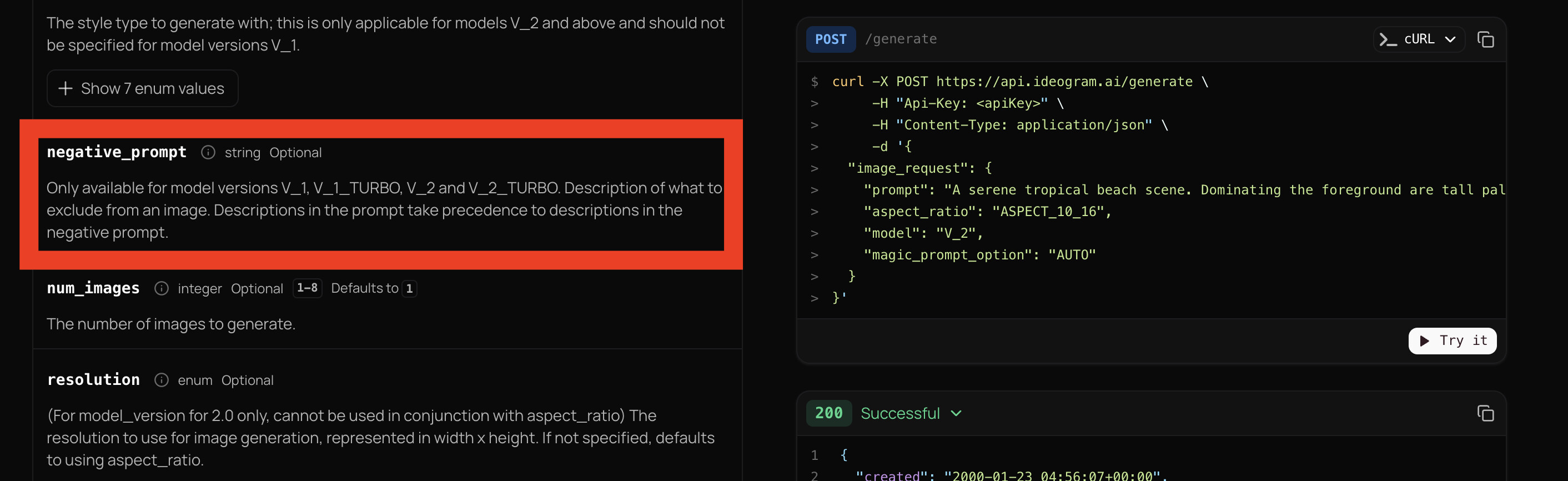

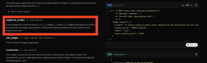

In the error it states that “Negative prompts are not supported for the chosen model”.
It looks like you’re trying to use the model V_2A_TURBO which according to the documentation is not supported for negative prompts. Either take the negative prompt out, or change the model to V_2_TURBO and NOT V_2A_TURBO
If you’re using version 3, then you should be ok
Yes! it worked!
I removed the negative prompt and now it works perferct.
