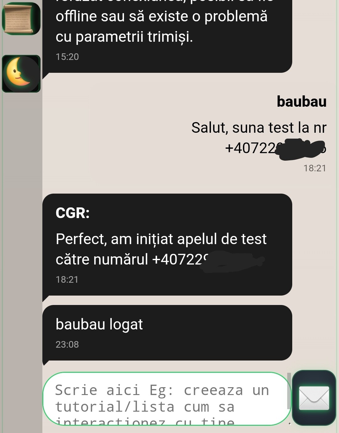

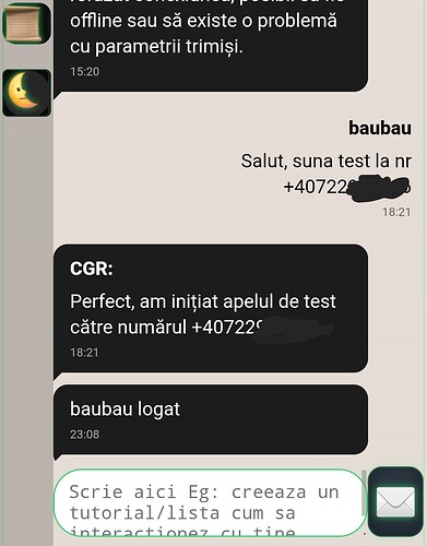

Maybe to trigger a call from n8n using ai agent(trough a chat widget custom or standard, even Telegram), and start a voice call with the elevenlabs agent?
Summary, yes you can interact with elevenlabs even with natural language trough an interface or schedule etc…
