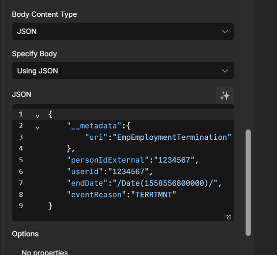

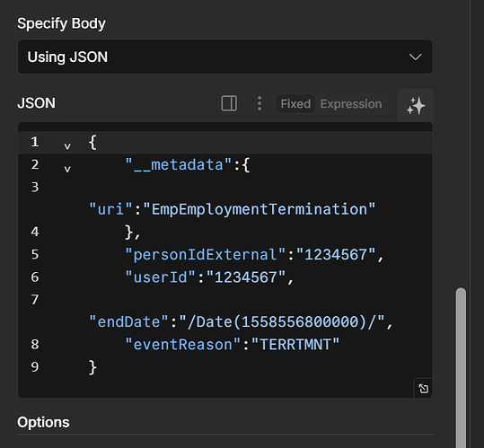

This is
Operation:
Upsert
HTTP Method
POST
URI
https:///odata/v2/upsert
Payload
	"__metadata":{
		"uri":"EmpEmploymentTermination"
	"personIdExternal":"1234567",
	"userId":"1234567",
	"endDate":"/Date(1558556800000)/",
	"eventReason":"TERRTMNT"

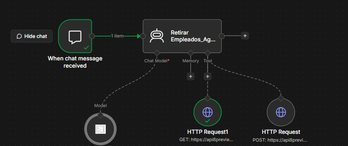

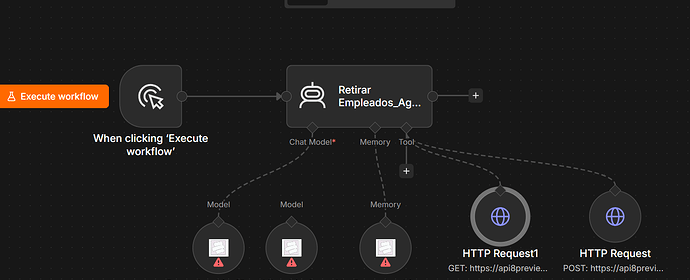

Hi

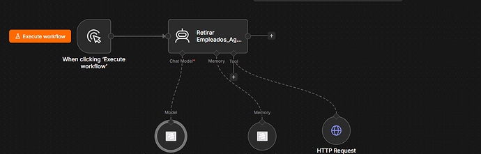

I’m creating this flow by connecting to a test instance:
Am I on the right track?
@testn8n_Santiago close, auth and payload are right (Basic Auth, correct datacenter, the EmpEmploymentTermination body). Two fixes:
  1. It’s on GET, which only reads. The termination is a write, so it has to be POST to /odata/v2/upsert (your body already has __metadata.uri, which is what upsert expects).
  2. A single HTTP Request still can’t do the CSRF handshake SF requires. You need two: a GET to /odata/v2/ with header X-CSRF-Token: Fetch and “Include Response Headers and Status” turned on (to grab the token + set-cookie), then the POST to /odata/v2/upsert carrying that X-CSRF-Token and Cookie plus your JSON.
A tool node is one call, so put those two requests in a small sub-workflow and attach that to the agent as a Call n8n Workflow tool. That’s what makes it actually fire.

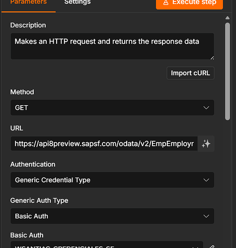

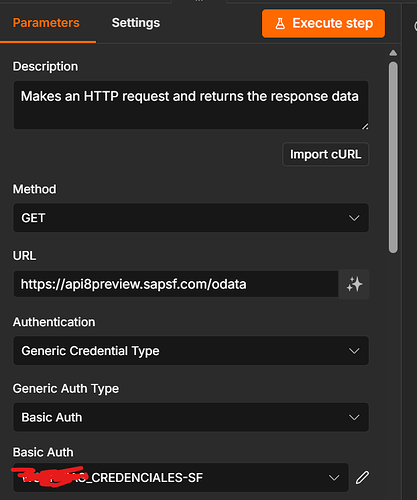

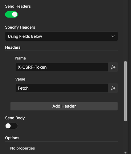

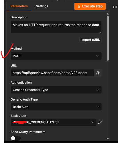

Hi, I’m sharing the settings and sorry, I’m already in the learning process and this is my first flow,

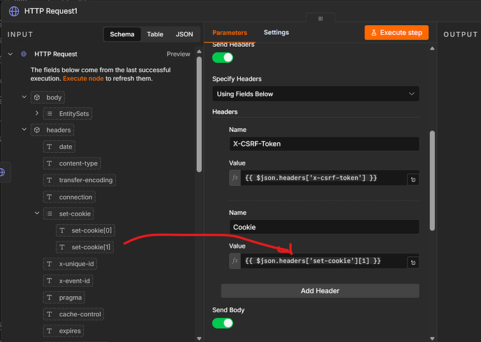

And for the second HTTP Request Node
Hey @testn8n_Santiago, you’re on the right track with the 2-step setup!
One thing to double-check on your second HTTP Request node (the POST): make sure you’re passing the x-csrf-token and cookie values from the response headers of the first GET, not hardcoded. In n8n you can reference them like:
X-CSRF-Token: {{ $(‘HTTP Request 1’).first().headers[‘x-csrf-token’] }}
Cookie: {{ $(‘HTTP Request 1’).first().headers[‘set-cookie’] }}
Also confirm your POST body has Content-Type: application/json set as a header, otherwise SuccessFactors may reject it even with a valid CSRF token.
Once those two nodes are working together, wrap them in a sub-workflow and connect it to your agent as a Call n8n Workflow tool, that’s the final step to make the agent actually trigger the termination. Keep that human approval step before it fires!

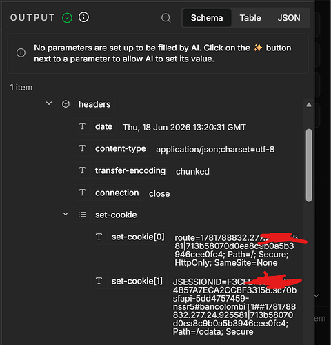

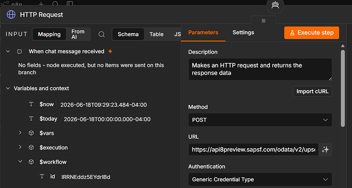

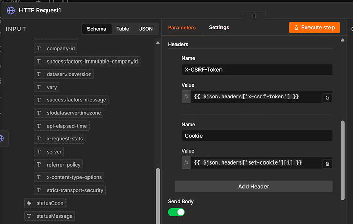

Hello
In the response from the first HTTP Request1, it returns the following response:
And I don’t know how to map it in the second node
@testn8n_Santiago your GET and POST are hooked up as two separate tools on the agent, so the POST cant see what the GET returned, its input panel only shows the chat trigger, not HTTP Request1. thats why theres nothing to map.
they need to run in sequence, GET then POST, inside a little sub-workflow that you hand to the agent as one Call n8n Workflow tool (not the two http nodes directly). once the POST sits after the GET you can pull:
X-CSRF-Token: {{ $(‘HTTP Request1’).item.json.headers[‘x-csrf-token’] }}
Cookie: {{ $(‘HTTP Request1’).item.json.headers[‘set-cookie’].join('; ') }}
also i didnt spot x-csrf-token in your GET response, so make sure the GET sends request header X-CSRF-Token: Fetch, thats what makes SF return the token.

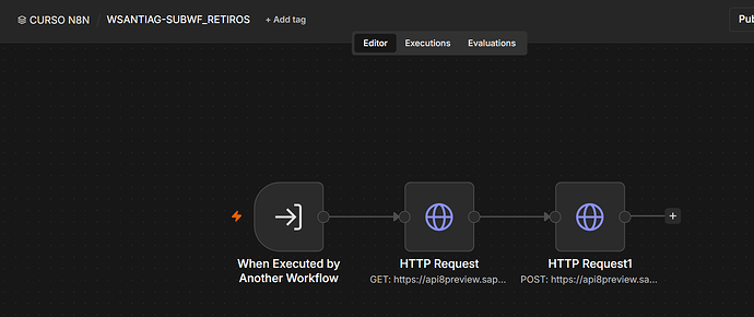

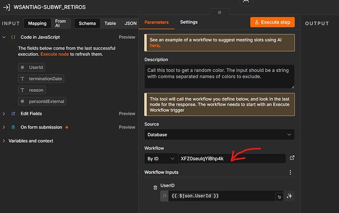

@achamm
I’ve followed your suggestions.

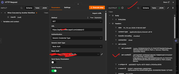

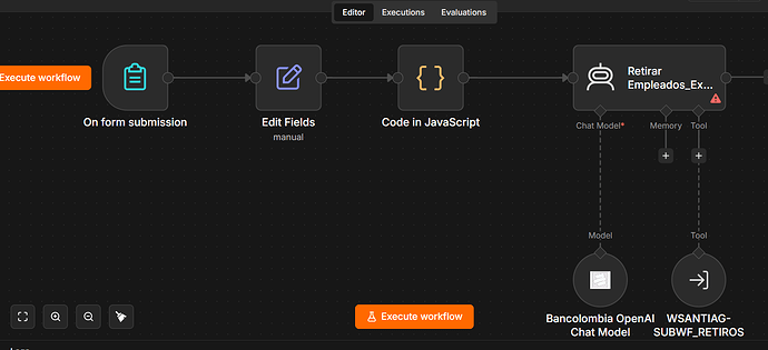

@testn8n_Santiago yeah youre on the right track, the hard part’s done. the sub-workflow is trigger → GET → POST as one Call Workflow tool, the GET is pulling the x-csrf-token (i can see it in its output), and the POST maps the token + cookie from it. thats the whole CSRF handshake working.
main thing to fix: the tools Description still has the default “random color, comma separated colors to exclude” text. the agent reads that to decide when and how to call the tool, so change it to what it actually does, something like “Terminates an employee in SuccessFactors. Input: the employees UserId.” thats almost certainly the warning on your agent.
small watch-out: the x-csrf-token shows url-encoded in the GET output (%2f, %2b etc). n8n usually sends it fine, but if the POST comes back 403 on CSRF, decoding that token is the first thing to check.
