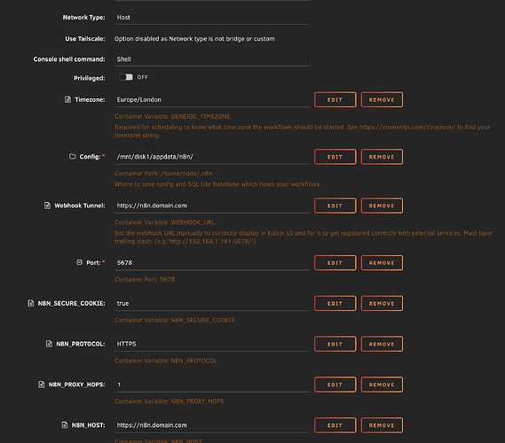

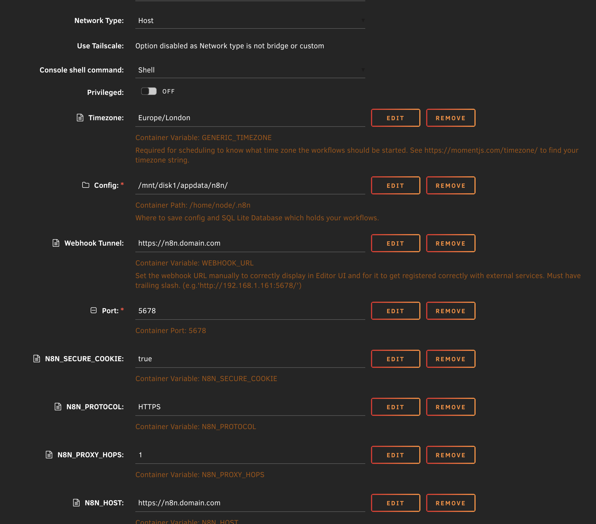

The config of my docker container is also below:
If anything else is needed or anyone has any ideas, please let me know.
