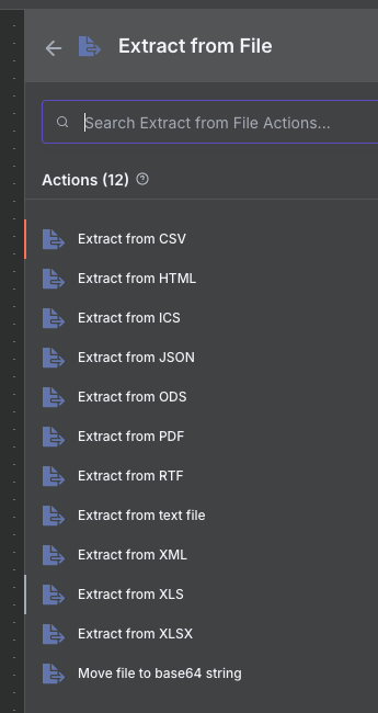

As for reaching xlsx, you can read them with the Extract from File node. which has Extract from XLSX operation:
Second from the bottom.
The node will take a binary (passed from the form, or a telegram node) and output the rows.
