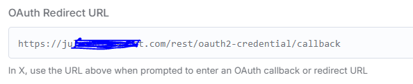

I need to setup https://ju…t.com/rest/oauth2-credential/callback with https.
The address in the callback in n8n is setup as ju…t.com/rest/oauth2-credential/callback (as in the image)
And I can’t seem to setup the https in front. I tried everything I could think of and find. Please find below my variables.

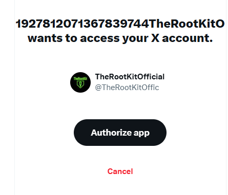

So as mentioned I modified the request, using the https:// in the request. And I accessed a new screen.
but when I hit authorize app, I am getting denied for the same error
