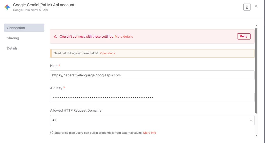

Couldn’t connect with these settings self-signed certificate in certificate chain
I m running n8n on my own laptop
the problem is i am trying to connect google chat model, while filling the credentials i am getting this error.
Error running node ‘Google Gemini Chat Model’
  • n8n version: don’t know i used docker to pull the image n8n/n8n.io something like that
  • Database (default: SQLite):simple memory
  • n8n EXECUTIONS_PROCESS setting (default: own, main):don’t know
  • Running n8n via (Docker, npm, n8n cloud, desktop app):docker desktop
  • Operating system:windows
Could you show a screenshot an the error?
Are there any proxies in your network/setup?

Hello mahe, welcome to the community!
I think that error means you Docker container cant validate Google’s TLS cert. Something on your machine/network (corp proxy, antivirus SSL inspection, self-signed CA) is man in the middling HTTPS, so Node.js inside the n8n container rejects the chain.
There are several suggestion that you can try:
  1. Export to your root CA as PEM (e.g. corp-root.pem) and mount it and point Node to it on docker-compose.yml.
services:
  n8n:
    image: n8nio/n8n:latest
    environment:
      - NODE_EXTRA_CA_CERTS=/certs/corp-root.pem
      # optional: bypass the UI credential test only
      - N8N_SKIP_CREDENTIAL_TEST=true
    volumes:
      - ./certs/corp-root.pem:/certs/corp-root.pem:ro
    ports:
      - "5678:5678"
The you can try to docker compose up -d, and retry the Gemini credential
  1. Add exception for generativelanguage.googleapis.com and (*.googleapis.com) in your proxy/AV and then restart the container.
Maybe thats all i can share, hope this will be works for you! :blush::raising_hands:
