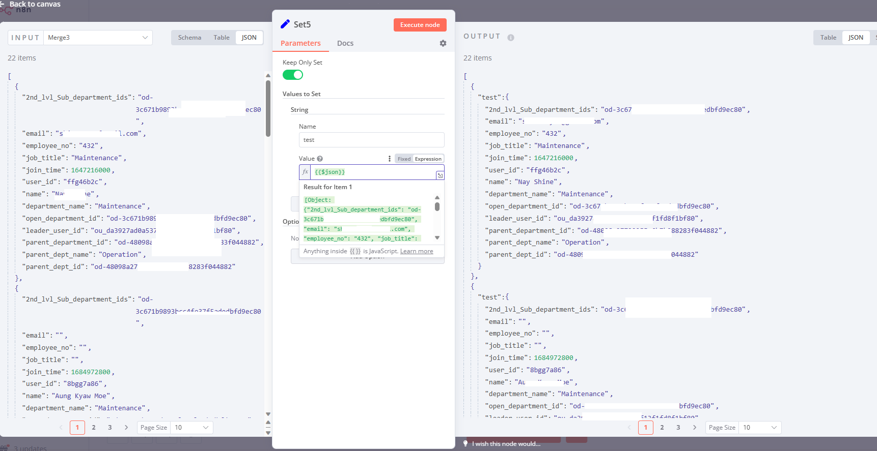

Hi @Benjamin123, looks like you can use the Set node here. Simply add a new field with a name of fields, as a value you can use an expression of {{ $json }}.

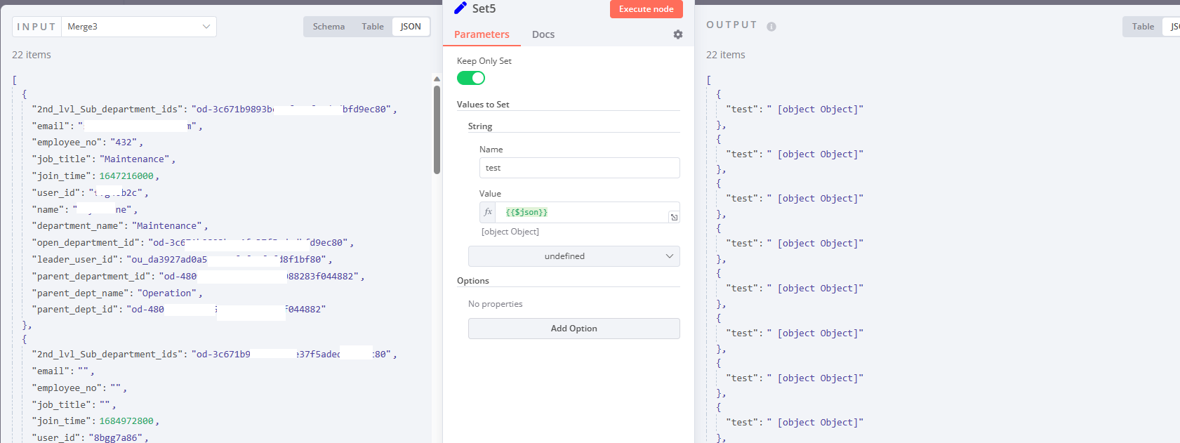

Hello @MutedJam , i get the result as below .

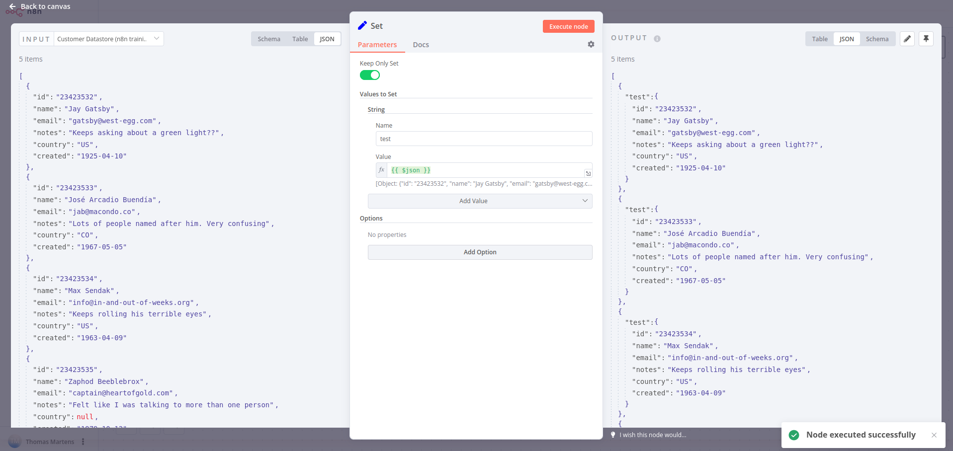

Huh, I did not expect this behaviour at all. Quickly testing this on [email protected], the approach seems to work fine using the below workflow:
Result:
