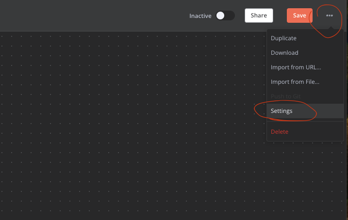

  1. That your timezone is set correctly in the workflow settings found here
  2. If it was correct, then try changing the timezone to UTC and inputing everything in UTC time.
