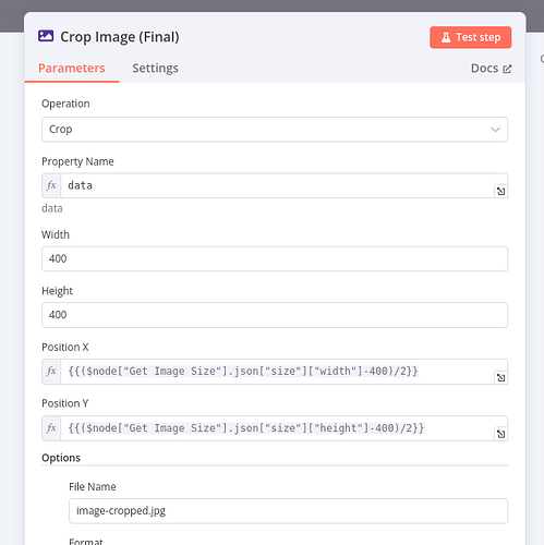

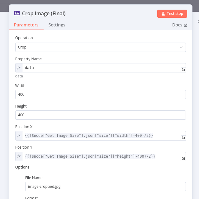

Your original image is 1200x1534. The image crop operation reduces that to 1080x1534 - not to 1080x1920. Try the following workflow, which first resizes to 1080x1920 (whichever is smaller), and THEN crops it.

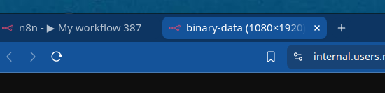

Also, you can easily check the actual image sizes in Chrome by clicking ‘view’ in the output node, then right-click on the image and select ‘open in new tab’ - the actual size will be the tab title:
As a final thought, I have found the image resize/cropping nodes to be rather unpredicatable sometimes, and in some cases it’s better to do the actual math yourself, and crop+position the final result based on the actual image dimensions instead. This will give you much more control over the result.
