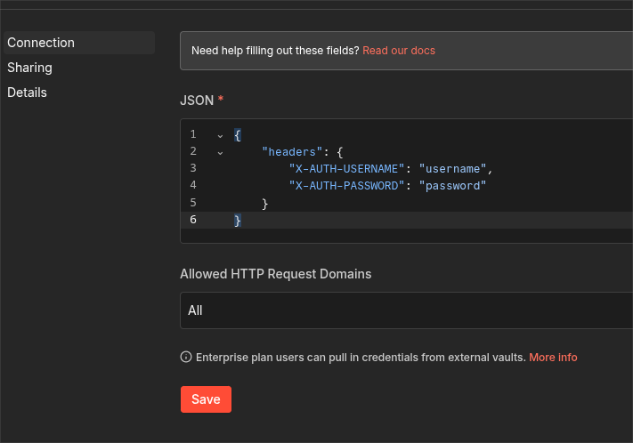

i have the Problem that since Update 2.13.3 the Custom Auth Credentials not saving anymore.
I can click edit enter anything in the JSON Field, click on Save and after a reload the JSON Field is empty again.
I updated to 2.13.4, but the problem persists.
For example the JSON from the Doc:
After Saving and reopening.
