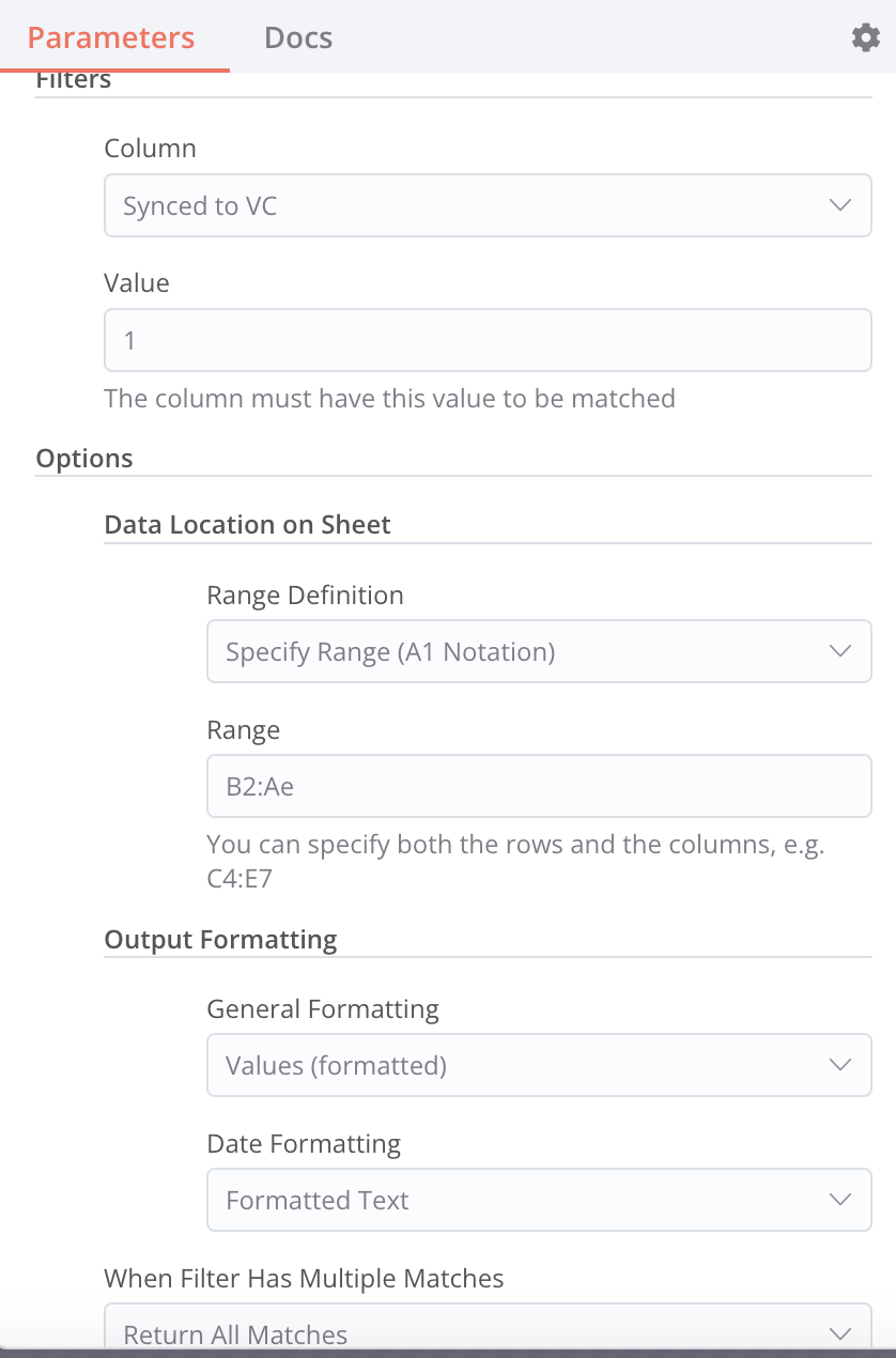

Here are the settings of the spreadsheet 1:
Here are the settings of the spreadsheet 2:
(we filter on a column of the spreadsheet - which was well set up at the time we didn’t retrieve correctly)

Oh, seeing this problem only occurs on your original spreadsheet but not on any copy of it, I think the underlying problem might not be with n8n but with the spreadsheet itself and it wouldn’t make much sense for me to work with the copy.
On a general note, n8n would only return the data it receives from the Google Sheets API and wouldn’t remove any items on its own. Is there a chance other users, applications, or scripts are accessing your original sheet while your n8n workflow runs?
Yes I know you return what you get from Google but sometimes there is less data at one trigger, while the one before and after have the same data (it’s like the Google API received too many requests and didn’t load some data at the end).
I’m wondering if it comes from the filtering option, because it really acts like the data is cached and not updated when it should have.
