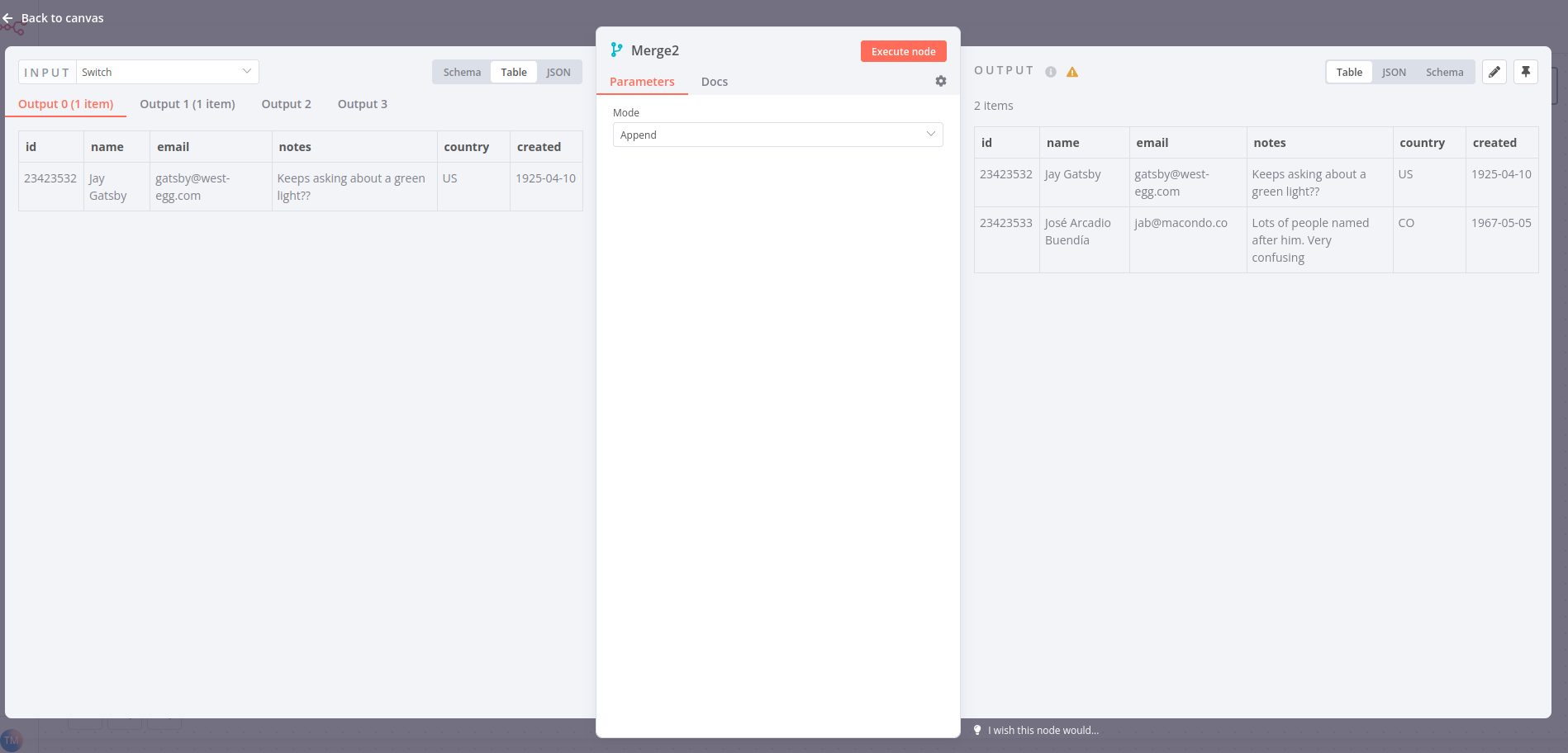

By the way, I’m wondering if “Merge – Append” would be able to output either input when the other input is empty? Because I have data that are split out “Switch” for value modification. However, not all of them will have data available for modification. After that, I would like to combine them back together as a whole.
Hi @BeStill, this should work for the most part, but there are two caveats:
  1. You’d need to upgrade to n8n version 1 for this to work. That’s because for previous versions of n8n the Merge node would try to pull in data even from branches that wouldn’t otherwise run which can lead to unexpected behavior. This change is documented here in the migration guide: n8n v1.0 migration guide | n8n Docs
  2. You’d need to use multiple Merge nodes and connect each of your Switch branches to its own input on the respective Merge node.
You’ll then be able to use a pattern like this:
This would return a single list of items after the last Merge node:
Hope this helps :slight_smile:
