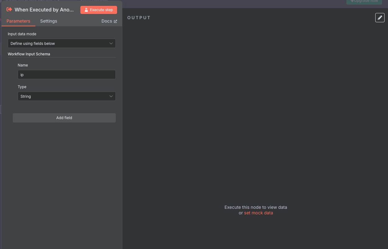

This next images shows the sub flow and the node that is supposed to be retrieving the output data seen in the previous image:
Both nodes were executed, yet no data is passing to the sub flow node.

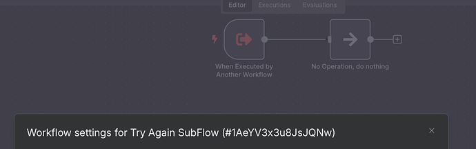

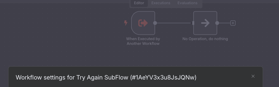

It is not working. Changing the mode setting to “Run once with all items” does not work. Plus that shouldn’t be an issue because the original mode allows me to utilize parallelization. The image below shows that executing the parent function and getting successful alerts still does not activate the sub-flow in on the right:
This image shows the same sub-flow and its name with its flow ID which matches the ID in the parent flow:

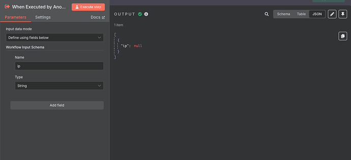

and yet I still get nothing:
Even manually executing the sub-flow doesn’t link the data from the parent flow - I still get null:

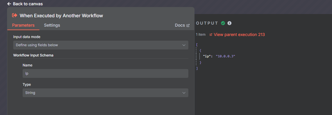

and when i manually triggered no data was passed but data was only present when i opened sub workflow from
give it a try and let me know.
I think you are right.
You can only see the data being passed through if you go to executions, or click “View sub-execution”. However if you are in the sub-flow editor and click on the nodes, it only shows you the fields with “null” or pre-set values; not the actual data being passed from parent flow.
I am not sure if this is by design because its a sub flow.
I can mark this as solved since there is a way to see the data coming through. I
If you are trying to use the sub-flow in a way that incorporates the data passed from parent flow then you would just have to use blank fields when setting up the nodes, run the parent flow, and then go evaluate how your data passed by looking at “Executions,” not “Editor”.
