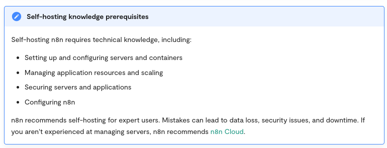

If you are not sure if you configured everything correctly or if you do not have the knowledge to host an application like n8n yourself I recommend you to look at our cloud solution, where we take care of the heavy lifting. We see a lot of self-hosters on the forum who lose workflows or have extended downtimes because of configuration issues and/or insufficient knowledge in for example, Docker. For that reason, did we add this warning to the docs:
