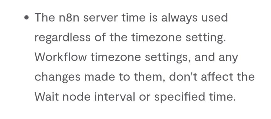

I’m the documentation of the Wait node I found this:
Try setting up the time manually, using the time picker. See if that works as expected.
If it does, then change the field to an expression and check how it is formatted.
The wait step is working, just not outputing anything.

hey thanks for the replies!
went with the assumption the expression of the date/time was incorrect.
after some tries this ended up working:
old
{{ $json.date + "T09:18:00-04:00" }}
new
{{ $json.date + "T09:18:00" }}
