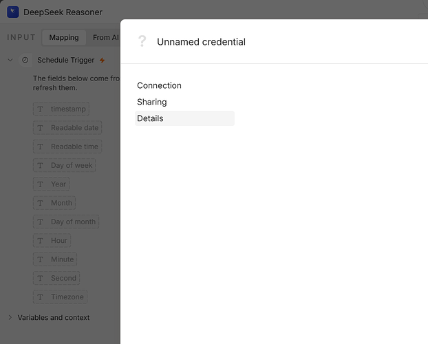

When I tried using the community node, my API key stopped working and when i try the official deepseek integration, it throws the same error as it did for you.
@Adam_Luka @calmlion1981 The community node uses its own credential type called “DeepSeek API” - it’s separate from the built-in DeepSeek credential. After installing n8n-nodes-deepseek-v4, go to Settings > Credentials > New, search for “DeepSeek API” (the one from the community node), and paste your API key there. Then in the node, click the credential dropdown and select that new credential. The key itself from platform.deepseek.com works fine - it just needs to be added under the correct credential type.
