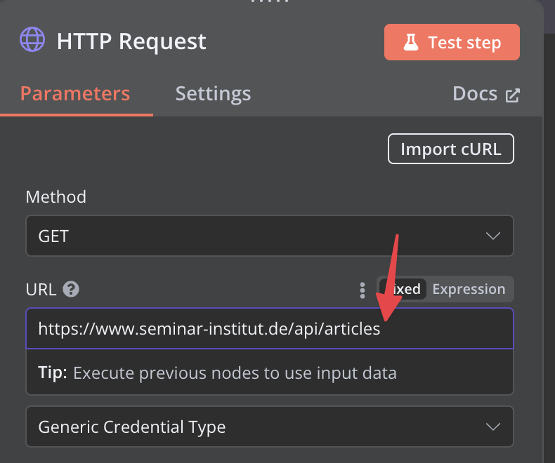

Hi, could you paste your workflow? But be careful not to expose you credentials.
If you need some hints on setting up credentials you could check this post
It seems like somehow it’s not using the credentials.
I have literally no clue why it would fail. As I said, I tried out everything that came in my mind and with cURL and Postman the Request works perfectly fine…
There seems to be a space at the end of the URL
Usually that’s not a problem but worth checking if that is your problem.
Also try adding a / after articles. I have had some API’s not liking the request without trailing /.
Sadly removing the space or adding a slash doesn’t make any difference
