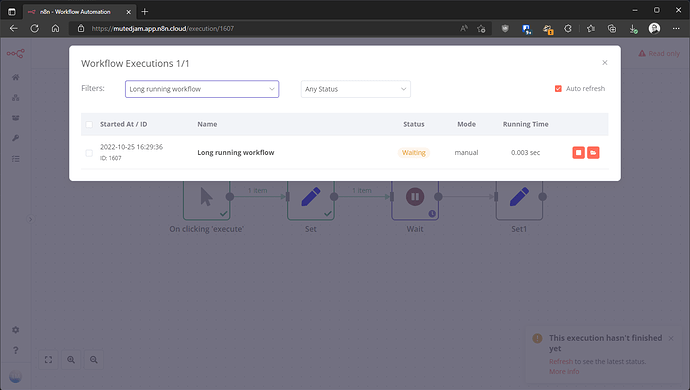

Yep, looking good. Started a workflow including a 10 minute wait, rebooted my instance, the workflow was still in waiting state with the execution data still available following the reboot:
It finished as expected once the waiting time was over, with the full execution data available:
Hope this helps!
