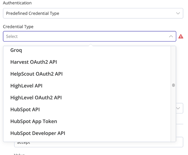

Do the HaloPSA credentials work with the http request node?
I’m doing a lot with assets in HaloPSA. Assets are one area of HaloPSA that isn’t handled at all in the HaloPSA node.
For these instances, the docs say to use credentials with the http node. The problem is, the http node does not list HaloPSA in the credentials field.
No error message, it’s just not there. I did check the node version number. It’s version 4.2.

You just need to use one of the Generic Credential Types.
So instead of selecting ‘Predefined Credential Type’, select ‘Generic Credential Type’, and then choose the option that matches your authentication choice.
You can learn more about the generic types here:
