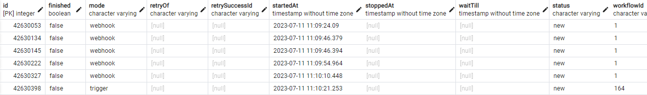

At last, in the database I’ve some playbook that are in status new since one or two hours

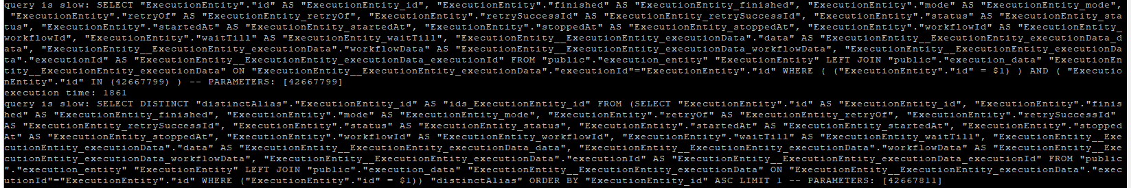

I see this message that come (very) often, and my container n8n main (the worker seems to work fine) crash after few minutes :

Just before the crash I’ve this error :

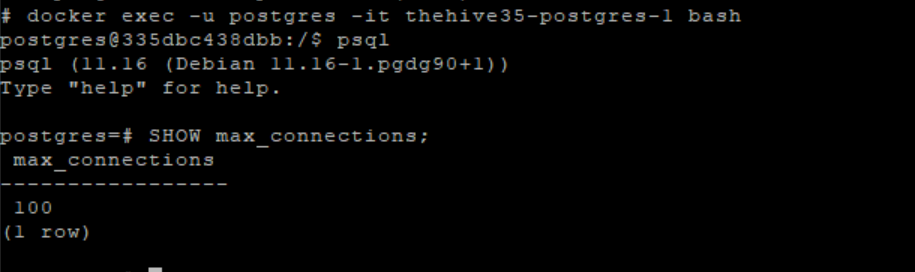

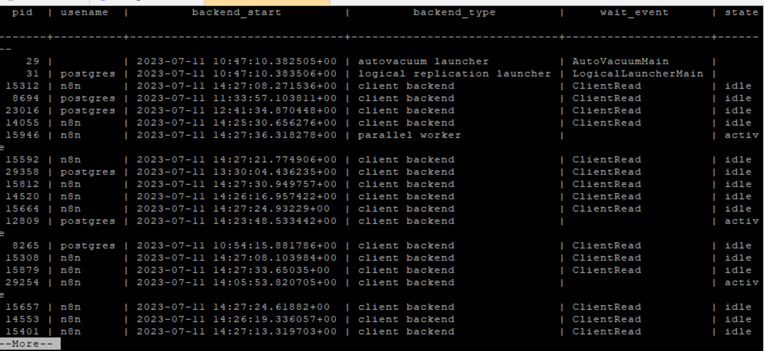

One thing that might help @krynble would be to check the general Postgres status using SHOW max_connections; (showing how many connections are currently allowed) and SELECT * FROM pg_stat_activity; (showing which connections are currently in use), and posting them here. This should look something like this:
sorry for the second command is too large to be post here
No worries, and thanks for sharing that! You might also want to try this while waiting for @krynble : postgresql - How to increase the max connections in postgres? - Stack Overflow

Once again thank you very much for your help. I increase this morning the number of max_connexion (set to 1000) and the shared_buffer too. I will let you know if it’s better or not.

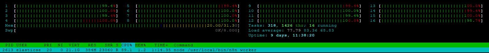

Since the upgrade our CPU usage is very high. We have 16 CPU and 32Go and all our CPU are at 100% :
